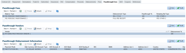

Funding > Contract Details tab > Funding stage should show the Passthrough Fee tab.
Description of passthrough-fee-3.png follows

Passthrough Vendors
Vendor List of vendors Y List of values NA Shows a list of active vendors defined in the setup and validates them for the application company.
  • If the application company and vendor company is not same, system should raise an EDIT.
Disbursement Value Indicates the amount to be disbursed Y Number 0 Accepts 2 decimals. Value validates that it should not exceed 100.
Enabled Record Enabled Indicator Y Check box No

Passthrough Fee Block
  • On click of 'Load Instrument', the system should load the passthrough fee information from the setup or alternatively, the user can add/edit the passthrough records using buttons.
  • If the user clicks on 'Load Instrument' again, the system may replace the user input values given in the passthrough tab; since it fetches information again from the contract setup.
  • Retaining Balance Type list of values should be based on current Contract Balances.
  • Retaining Balance Type should have passthrough flag = N
Passthrough Vendors
Logic to display vendors in the 'Passthrough Vendors' tab:
  • System should display the list of vendors belonging to the account company and status = ACTIVE.
  • Only one vendor is allowed for selection for each fee.
Passthrough Disbursement Information On Save of vendor record, the system will populate the information w.r.t vendor table. Only VIEW option is available and if the user wants to make any changes, they must do it in the vendor tab to fetch latest information.
