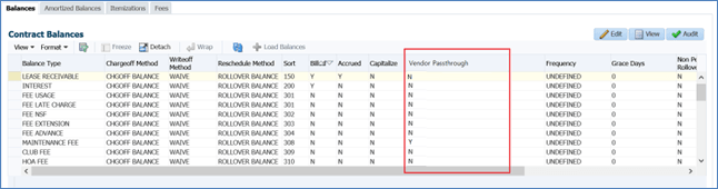

The following changes have been made in the Setup > Contract >Balances sub
tab.
Table 2-2 Setup Changes
Parameter Code | Description | Mandatory Y/N | Data Type/ Size | Default Values | Field Validation and Comments |
BALANCES TAB | |||||
Vendor Passthrough | New flag in Contract balances | Y | Checkbox | N | This indicates that a certain balance is enabled for
'Pass-through'.
For the current scope, the pass-through flag is supported for 'Fee Balances'. The system allows to flag pass-through only for fee type 'FPMF' and if user tries to select any other fee for pass-through, it raises the error 'Pass-through flag supported for Fee Periodic Types only.' |

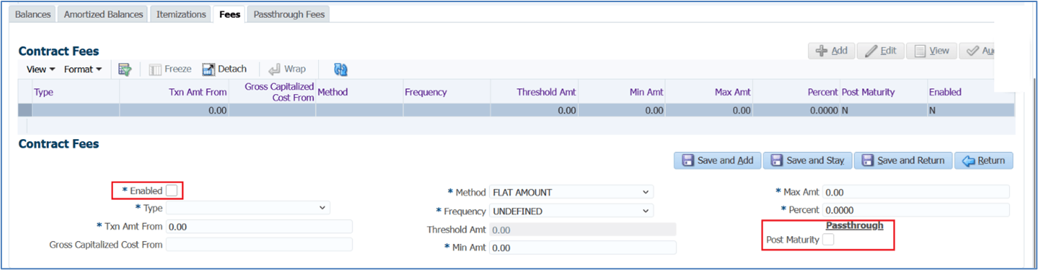

Navigate to Contract Setup > Fee (Changes in existing tab).
- Introduced a new check box 'Post Maturity'. If the flag value is 'Y', it indicates that the pass-through rate applicable for post-maturity is also applicable to the account.
- Here, 'Post Maturity' indicates whether the 'Evergreen' txn was posted for the Lease account or not.

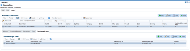

Table 2-3 Passthrough Fees
Field Name | Description | Mandatory | Type | Default Value | Comments |
Passthrough Fees | |||||
Balance Type | Account balances enabled for vendor pass through | Y | List of values | NA | Shows list of 'FPMF (Fee Periodic Maintenance Fee)' balances attached to the contract. |
Disbursement Type | Indicates the passthrough disbursement | Y | List of values | NA |
New lookup→ Passthrough Disbursement Method. Values→ Billing date, Full Fee Receipt. |
Passthrough | Indicates the passthrough % to be processed | Y | Number | 100 | Accepts 2 decimals. No negative number allowed. Should not exceed 100. |
Retaining Bal Type | Account balance to select the lessor retention balance | Y | List of values | NA | Shows list of fee balances attached to the contract for selection. (Not enabled for Passthrough). |
Enabled | Record Enabled Indicator | Y | Check box | No |
- Retaining Balance Type LOV based on current Contract Balances.
- Balance Type and Retaining balance type should not be same.
- Retaining Balance Type has passthrough flag = N.
- System should not allow to configure same Periodic fee more than once on an account for passthrough. If the user tries to configure the duplicate fee, raise an error: "Same Fee type cannot be configured."
Currently scope is to support the 'Passthrough' feature at the 'Contract definition' level. Global Fee definition is not supported.Parent topic: Vendor Passthrough Support for Lease
