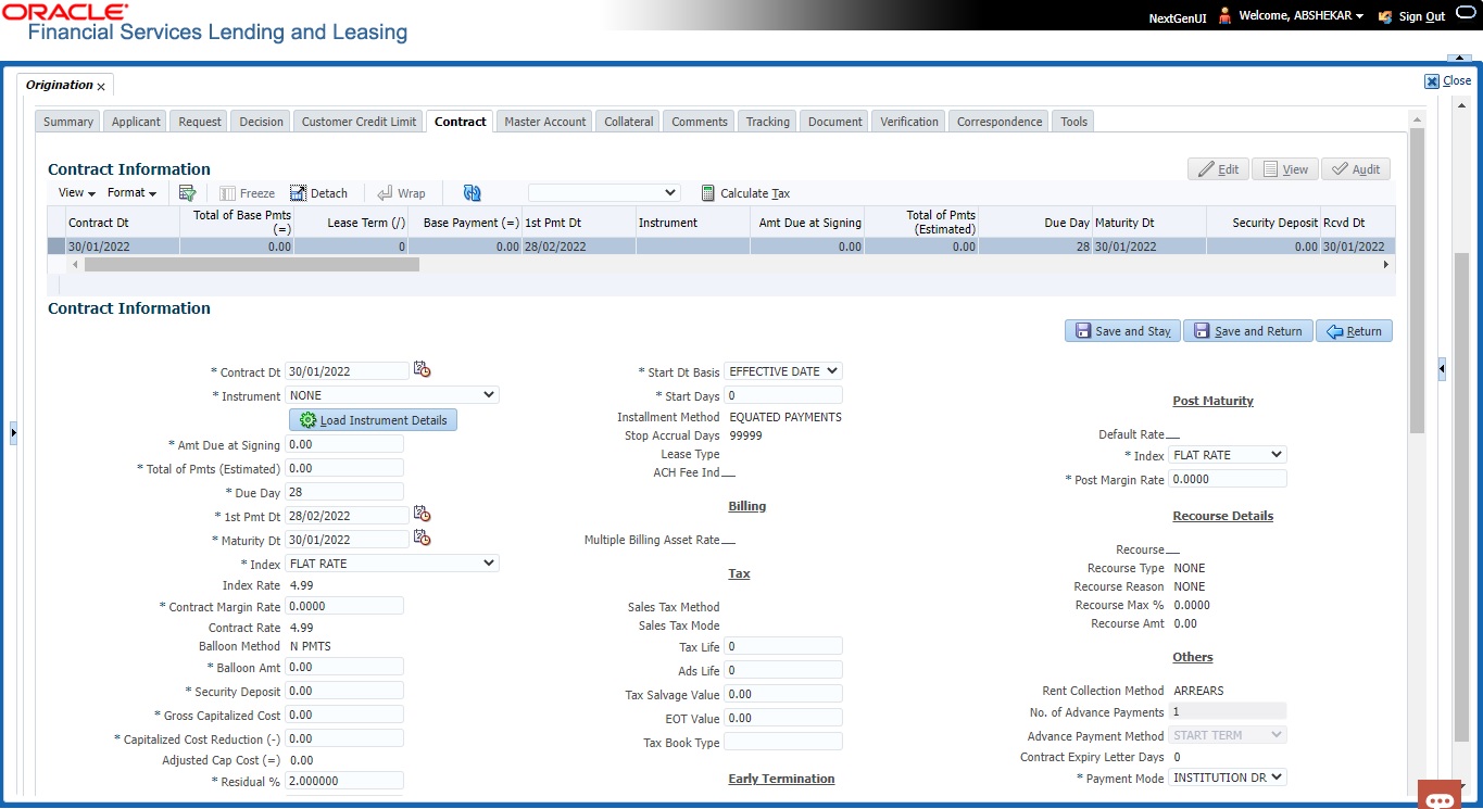

A brief description of the fields is given below:
Table 8-1 Contract Information
Field Description Contract Displays the contract section. Contract Dt Specify the contract date. Instrument Select the required instrument from the drop down list and click on Load Instrument Details. Amt Due at Signing Enter the prepaid amount. Total of Pmts (Estimated) Enter the estimated total of payments. Due Day Specify the due day. 1st Pmt Dt Specify the first payment date. Maturity Dt Specify the maturity date. Index Select the applicable index type from drop-down list.
Note: If the lease calculation method is selected as Rent Factor, then Flat Rate Index type is applicable by default.
Index Rate Specify the approved index rate. Contract Margin Rate Specify the contract margin rate. Contract Rate Specify the contract rate. Amortization Rate Specify the Amortization Rate for the Lease Contract. This is the rate used to generate the amortization schedule. The default value is maintained as '0.000'. Balloon Method Displays the balloon payment method.
Note: This field is displayed only if the lease calculation method is Interest Rate.
Balloon Amt Specify the balloon amount.
Security Deposit Specify the security deposit amount. Gross Capitalized Cost Enter the gross capitalized cost. Capitalized Cost Reduction (-) Enter the cap cost reduction. Adjusted Cap Cost (=) Enter the adjusted cap cost. Residual % Displays the residual percentage. Residual Value (-) Enter the residual value. Depreciation Value (=) Specify the depreciation value. Rent Charge (+) Enter the rent. Rent Factor Displays the rent factor. Note: This field is applicable only if the lease calculation method is selected as Rent Factor.
Total of Base Pmts (=) Enter the total of payments. Lease Term (/) Enter the term. Base Payment (=) Enter the payment amount. Estimated Tax (+) Enter the estimated tax amount. Tax Displays the tax percentage. Estimated Pmt (=) Enter the payment amount percentage. Rcvd Dt Specify the date on which deposit is received. Verified Dt Specify the contract verification date. Verified By Displays the user id who verified the contract. Depreciation The depreciation details defined in Setup, click Contractunder Contract, click Lease screen are auto populated in this section and can be modified as required. The same is used for asset depreciation calculation when the batch job TAMDEP_BJ_121_01 (DEPRECIATION RATE PROCESSING) is executed. Depreciation Start Dt System auto populates the contract date as the default date for Depreciation Start Date. User can enter the required depreciation start date from the adjoining calendar. Ensure that date selected is not earlier than lease contract date or greater than account maturity date. Depreciation accounting is done from this date onwards and is calculated till the time asset is associated with this Account.
Depreciation Method View / Select the asset depreciation method to be used for calculation as one of the following from the drop-down list. - FLAT RATE: This method is used to depreciate the asset over a fixed time using a fixed rate. This method of calculation is similar to Written Down Value Method (Diminishing Balance Method / Reducing Installment Method). On selecting this option, the details specified in Contract Setup screen for the following fields - Base Rate, Adjusting Rate and Bonus Rate are considered for calculation.
- LIFE BASED: This method is used to depreciate the asset over a fixed time using the specified rates. This method of calculation is similar to Straight Line Method (Original Cost Method / Fixed Installment Method). On selecting this option the details specified in Depreciation Rate Schedule sub tab of Contract Setup screen is considered for calculation.
Depreciation Convention View / Select the frequency at which the leased account should be updated with depreciation details from the drop-down list. The list is populated with frequency details (i.e. monthly, weekly, and so on) maintained in ‘FIRST_LAST_YEAR_CONVENTION_CD’ lookup code. Payment Caps Displays the payment caps section. Max Pmt Increase / Year The maximum payment that can be increased for the year. Max Pmt Increase / Life The maximum payment that can be increased in the life of an application. Instrument Details An instrument is a contract with specific rules tied to it. An instrument associated with the application indicates OFSLL of the type of contract being used for the approved lease. Items defined in the contract are locked in when user select the instrument from drop down list and click on Load Instrument. These values cannot be changed on the funding screen. Any changes to the instrument in account will be handled by monetary/non-monetary transactions.
The system loads all the rules established by the company that are required at the time of funding; for example, the accrual method, billing method, type of billing, tolerance, due dates, extensions and so on.
Calculation Method Displays the type of interest calculation method used for the selected instrument. Accrual Method Displays the accrual calculation method. Base Method Displays the accrual base method. Bill Method Displays the billing method. Bill Type Displays the billing type. Time Counting Method Displays the time counting method. Calendar Method Displays the Calendar Method. Start Dt Basis Select to define the start date from when the interest accrual is to be calculated for this instrument from the drop-down list. Note:- If user select the Effective Date, then the interest is calculated from the Contract date + Start Days (indicated below).
- If user select the Payment Date, then the interest is calculated based on (first payment date + Start Days (indicated below) minus one billing cycle).
Start Days Specify the number of grace days after which the interest accrual is to be calculated. Ensure that the number of grace days is less than first payment date. Installment Method Displays the installment methods. Stop Accrual Days Displays the accrual stop days. Lease Type Displays the type of lease such as Direct Finance or Operating Lease. ACH Fee Ind Indicates that the ACH fee should be applied or not. Depending on the status of check box, the ACH fee is applied based following conditions: - When the check box is selected and the fee amount is ZERO, system will not apply the ACH fee.
- When the check box is selected and the fee amount is BLANK, system will apply the ACH fee from Contract setup.
- When the check box is selected and the fee amount is specified, system will apply the specified amount and overrides the ACH fee amount mentioned in Contract Setup.
- When the check box is not selected, system will apply the ACH fee amount mentioned in Contract Setup.
Billing Displays the billing section. Multiple Billing Asset Rate Check this box to indicate if multiple asset rates are applicable for one billing period. System considers billing period from current due date to the next due date. Multiple rates are fetched only when rate end date (rate start date + rate frequency) ends one or more cycle(s) before the next due date i.e. current rate record does not cover the entire billing period.
Tax Displays the tax section. Tax Method Displays the tax method used for tax calculation. Tax Mode Displays the tax mode. Tax Life Displays the tax life. Ads Life Displays the ads life. Tax Salvage Value Displays the tax salvage value. EOT Value Displays the EOT value. Tax Book Type Displays the tax book type. Early Termination Displays the early termination section. Allowed To Terminate If checked, indicates that early termination of lease contract is allowed. Billed Term Displays the total billed amount on the lease contract. Lease Amt Recovered % Displays the percentage of lease amount recovered against the lease contract amount during early termination. Residual Details Displays the residual details section. Minimum Residual % Displays the minimum residual percentage valid with lease contract. Maximum Residual % Displays the maximum residual percentage valid with lease contract. Residual Value In Final Bill If checked, indicates that residual amount (if exist) can be included in the final bill. Residual Valuation Displays the type of residual valuation method. PDC Displays the PDC section. PDC Ind If selected, indicates that the customer has opted for PDC. PDC Security Ind If selected, indicates that the customer has submitted the PDC as a security. Rate Caps and Adjustments Displays the rate caps and adjustments section. Note: This section is displayed for Interest Rate type of lease calculation method.
Increase Per Year Displays the maximum rate increase allowed in a year. Increase Max Lifetime Displays the maximum rate increase allowed in the life of the Lease. Increase Floor Displays the rate cap (minimum). Increase Ceiling Displays the rate cap (maximum). Decrease Per Year Displays the maximum rate decrease allowed in a year. Decrease Max Lifetime Displays the maximum rate decrease allowed in the life of the Lease. # of Adjs / Year Displays the maximum number rate changes allowed in a year. # of Adjs / Life Displays the maximum number of rate changes allowed in the life of the Lease. Post Maturity Displays the post maturity section. Note: This section is displayed for Interest Rate type of lease calculation method.
Default Rate If selected, indicates the default rate is available. Index Select the post maturity index. Post Margin Rate Specify the past maturity rate. Recourse Details Displays the recourse details section. Recourse Displays the recourse indicator. If selected, it indicates that there is a recourse associated with the Lease and the following recourse details can be specified. Recourse Type Select the recourse type as either Partial or Full from the drop-down list. Recourse Reason Depending on the type of recourse selected, user can select the following type of recourse reason from the drop-down list. For recourse type as Partial, system defaults the recourse reason as Partial.
For recourse type as Full, user can select one of the following options:- Fraud
- Titles
- Fraud and Titles
- Full
- Full and Titles
Recourse Max % Specify the maximum percentage of recourse allowed. Ensure that the specified amount does not exceed 100% or the amount defined at Contract. Note: User can specify the recourse either in percentage or as flat amount in the below field.
Recourse Amt If Recourse Max % is not specified, user can specify a flat amount to be allowed for recourse. Others Displays the others section. Rent Collection Method Displays the type of rent collection method as either Advance or Arrears. For Interest Rate type of lease calculation, both Advance and Arrears are applicable. For Rent Factor, only Advance method is applicable.
Contract Expiry Letter Days Displays the total number of days the lease contract is valid after the contract expiry. Payment Mode Select the type of repayment mode to indicate if it is Autopay/ Direct Debit or not using any of the following option from the drop-down list. The list is populated from REPAYMENT_PMT_ MODE_CD lookup code. - INSTITUTION DRAFT / CHECK (default)
- AUTOPAY (ACH)
- AUTOPAY (CREDIT CARD)
- AUTOPAY (DEBIT CARD)
- POST DATED CHECKS
For an AUTO PAY type of Payment Mode, ensure that at least one active ACH record exist and for CHECK type of Payment Mode, there are NO active ACH records.
Statement This section allows to define the preferences for Mock Statement generation at Master Account level. Generating a Mock Statement helps to mock the asset billing process with a future date and to get an upfront statement indicating future dues of Master and Associated Accounts. In Vacation Ownership industry, such statements are required to forecast future dues based on current Timeshare holdings. The default populated preference here are propagated from Setup under Setup, click Administration under Administration, click Products under Products, click Contract screen when the instrument is loaded.
Note: These fields are enabled only for Master Account, i.e. only if the Master Account check box is selected in Origination, click Master Account tab. If the option is unchecked even at a later point, system refreshes these fields making them as Read-Only.
Stmt Preference Mode Select the account statement preference mode as either Email or PHYSICAL from the drop-down list. Mock Statement Req Select this check box to indicate if the account is to be included in Mock statement Generation. Note: Based on this selection, others fields related to Mock Statement below are enabled and becomes mandatory for providing details.
Mock Start Month Select the start month of Mock Statements period from the drop-down list. Mock Statement Cycles Select the total number of billings (between 1-12) that are to be generated post Mock Statement Start Date. Mock Pre Statement Days Specify the number of Pre bill days for Mock Statements generation. Capitalization This section displays the capitalization parameters pre-defined at Setup, click Contract screen and allows user to modify only the Grace Days value for balance capitalization. Capitalize If selected, indicates that the capitalization of balances is enabled while funding the application. Frequency Displays the capitalization frequency defined at Contract level.
After funding, all the account balances are capitalized to principal in the same frequency except for Balance Frequency where different frequency may be defined for each balance type.
Capitalization Start Basis Displays the capitalization start date as either Contract Date or First Payment Date on which capitalization next date is calculated. Grace Days View or Modify the grace days allowed in the frequency (minimum 0, maximum 31) before capitalizing the balances to account. This is also the deciding factor for executing the capitalization batch job which is based on Capitalization Frequency + Grace Days.
However, note that Grace Days are not accounted for Month End type of capitalization frequency and is ignored even if specified.
Cap Tolerance Amt Displays the capitalization tolerance amount which is the minimum amount to qualify for capitalization. Promotion Details If applicable, enter information regarding any promotion associated with the application in the Promotion section. The Promotion details maintained in Setup, click Products under Products, click Promotions are populated here. Promotion Select the promotion. Type Displays the promotion type. Dlq Days Displays the delinquency days. Period Type Displays the period type. Period Displays the promotion period. Tolerance Amt Displays the tolerance amount. Index Displays the promotion index. Index Rate Displays the promotion index rate. Promotion Margin Rate Displays the promotion margin rate. Promotion Rate Displays the promotion rate. Agreement Details Displays the agreement details section. Agreement Number Specify the agreement number which is to be associated to the application. Note: On funding, this agreement number is also associated to the account and in-turn helps to group all those accounts with a particular agreement number.
