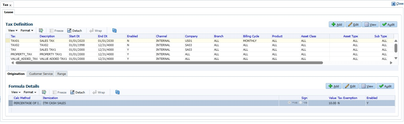

The Origination tab of Tax screen facilitates to capture details for upfront tax calculation during Origination which is based on Purchase Price, Itemization/Lease Payment amount, and Total of Lease Payments.
  1. On the Setup, click Administration. Under Administration, click System.
  2. Under System, click Tax. Under Tax, click Lease. Under Lease, click Origination.
    The Origination screen displays.
  3. In the Formula Details section, click Add. User can also perform any of the Basic Operations mentioned in Navigation chapter. A brief description of the fields are given below:

    Itemization
    Select the required itemization from the drop-down list. User can define multiple itemization for the selected calculation method to determine tax.
    Note: This field is available only if the calculation method is either FLAT ITEMIZATION AMOUNT or PERCENTAGE OF ITEMIZATION AMOUNT.
    Sign
    Select +ve option (default) if the calculated tax amount is to be added to the lease application or -ve option if a tax rebate is given on the lease application.
    Note: This field is displayed only for Internal tax calculation method.
    Value
    Based on the calculation method selected, specify either amount or percentage of tax to be calculated.
    Tax Exemption
    Check this box to indicate if the tax formula can be exempted from tax calculation for lease applications having valid exemption details. Else, tax is assessed for lease application using this tax formula.
    Note: This check box is displayed only for Internal tax calculation method.
    Enabled Check this box to enable the tax formula.
