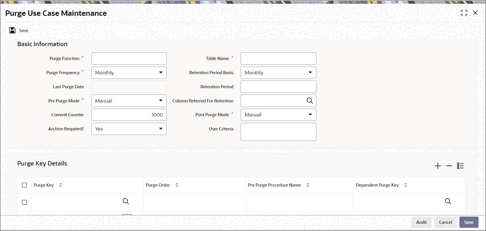

  1. On Home Screen, type UTDFNPUR in the text box, and click Next.
    The Purge Use Case Maintenance screen is displayed.
    Figure 1-3 Purge Use Case Maintenance
  2. On Purge Use Case Maintenance screen, click New to enter the details.
    Table 1-2 Purge Use Case Maintenance - Field Description
    Field Description
    Basic Information Section This section displays all basic details.
    Purge Function
    Alphanumeric; 16 Characters; Mandatory
    Specify the purge function details.
    Purge Frequency
    Mandatory
    Select the purge frequency from the drop-down list. The list displays the following values:
    • Daily
    • Monthly
    • Fortnight
    • Quarterly
    • Half Yearly
    • Yearly
    Last Purge Date
    Display
    The system displays the last purge date.
    Pre Purge Mode
    Mandatory
    Select the pre purge model from the drop-down list. The list displays the following values:
    • EOD
    • Manual
    Commit Counter
    Numeric; 8 Characters; Mandatory
    Specify the commit counter.
    Archive Required?
    Optional
    Select if archive is required or not from the drop-down list. The list displays the following values:
    • Yes
    • No
    Table Name
    Alphanumeric; 50 Characters; Mandatory
    Specify the table name.
    Retention Period Basis
    Optional
    Select the retention period basis from the drop-down list. The list displays the following values:
    • Daily
    • Monthly
    • Fortnight
    • Quarterly
    • Half Yearly
    • Yearly
    Retention Period
    Numeric; 8 Characters; Optional
    Specify the retention period.
    Column Referred For Retention
    Alphanumeric; 50 Characters; Optional
    Specify the column referred for retention.
    Post Purge Mode
    Mandatory
    Select the post purge mode from the drop-down list. The list displays the following values:
    • EOD
    • Manual
    • Automatic
    User Criteria
    Alphanumeric; 2000 Characters; Optional
    Specify the user criteria details.
    Purge Key Details This section displays the purge key details.
    Purge Key
    Alphanumeric; 100 Characters; Mandatory
    Specify the purge key. Alternatively, you can select purge key from the option list. The list displays all valid purge keys maintained in the system.
    Purge Order
    Numeric; 2 Characters; Optional
    Specify the purge order.
    Pre Purge Procedure Name
    Alphanumeric; 35 Characters; Mandatory
    Specify the pre purge procedure name.
    Dependent Purge Key
    Specify the dependent purge key. Alternatively, you can select dependent purge key from the option list. The list displays all valid dependent purge keys maintained in the system.
