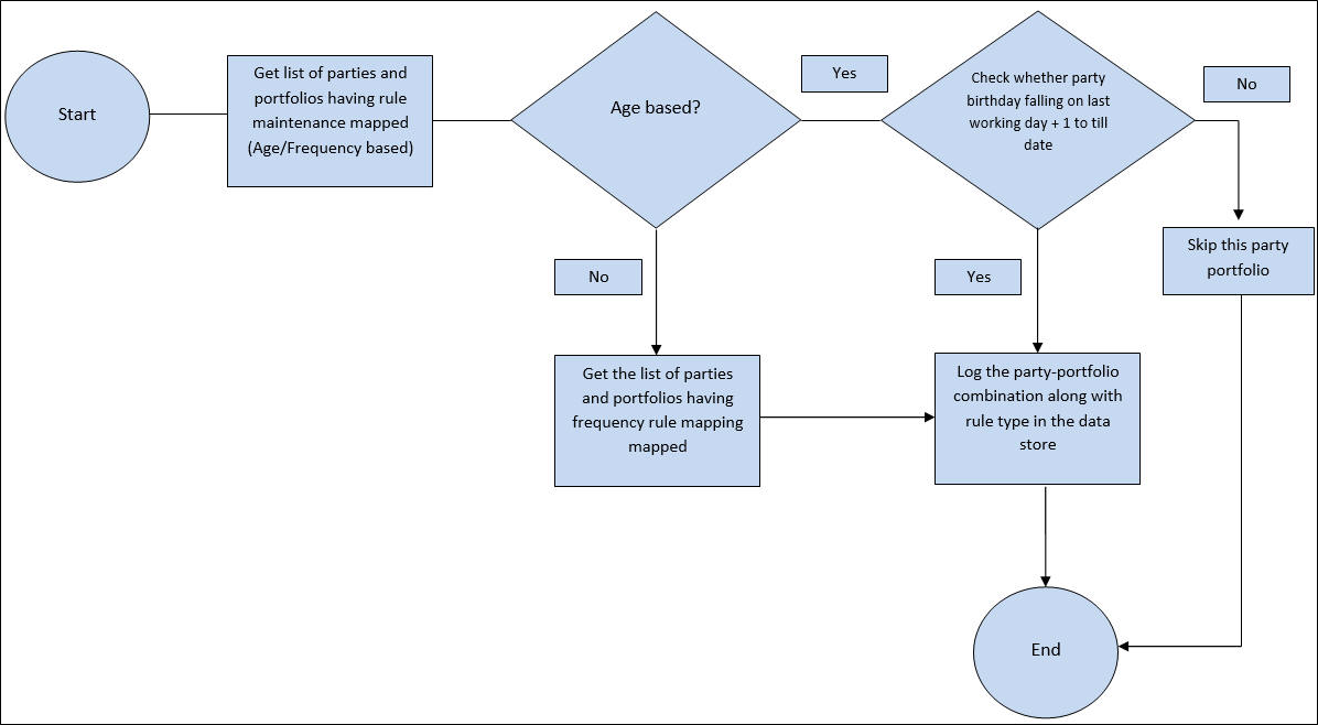

  1. Evaluate the party, portfolio combination to check if an age slab change and portfolio amendment is required.
    Figure 1-22 Step 1 of Process Flow

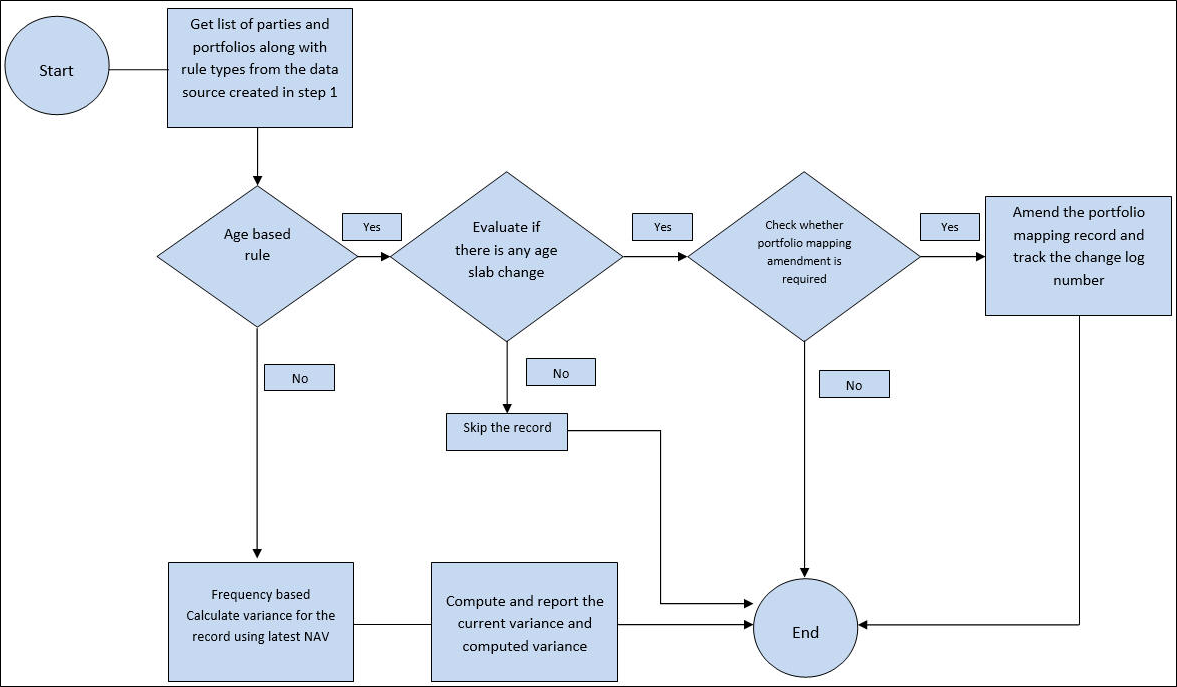

  2. Process rebalance, amendment of portfolio mapping for age based and logging of variance in case of frequency based.
    Figure 1-23 Step 2 of Process Flow

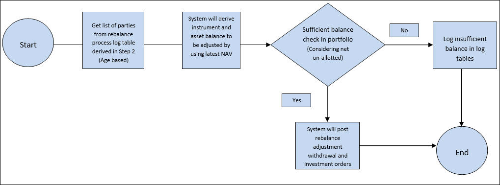

  3. Adjustment order generation for outflow and inflow for age based rules.
    Figure 1-24 Step 3 of Process Flow
