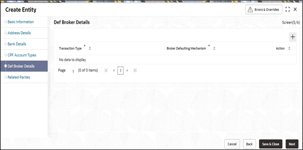

2.7 Default Broker Details
This topic explains the Default Broker Details of Create Entity screen.
  1. On Create Entity screen, click Default Broker Details tab to maintain the following Default Broker details.
    The Default Broker Details screen is displayed.
    Figure 2-9 Default Broker Details
  2. On the Default Broker Details screen, click Add icon to specify the fields.
