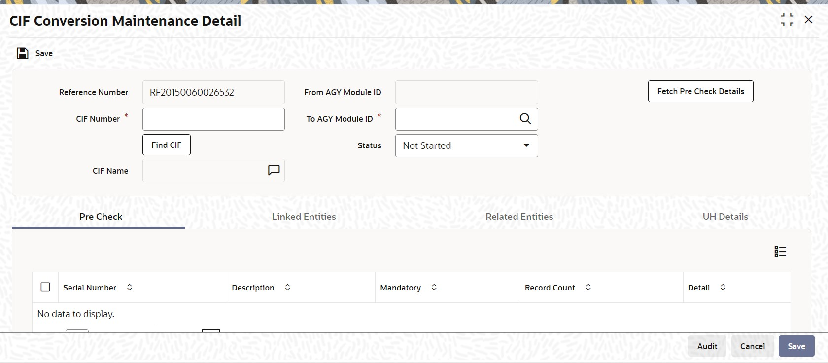

  1. On Home screen, type UTDCIFCM in the text box, and click Next.
    The CIF Conversion Maintenance Detail screen is displayed.
    Figure 1-24 CIF Conversion Maintenance Detail
  2. On CIF Conversion Maintenance Detail screen, click New to enter the details.

  3. Click the Fetch Pre Check Details button to identify the pending business for the CIF.
