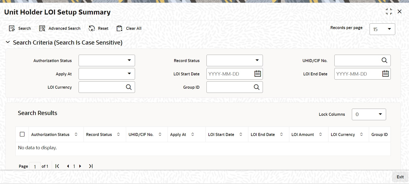

  1. On Home screen, type UTSUHLOI/ UTSUHLOA in the text box, and click Next.
    The Unit Holder LOI Setup Summary screen is displayed.
    Figure 3-9 Unit Holder LOI Setup Summary
  2. On Unit Holder LOI Setup Summary screen, specify any or all of the following details in the corresponding fields:
    • Authorization Status - If you choose the status, then the records matching the specified status are retrieved. If you do not choose any option, then all the records are retrieved.
    • Record Status
    • Unit Holder/ CIF Number
    • Apply At
    • LOI Start Date
    • LOI End Date
    • LOI Currency
    • Group ID
  3. Click Search button to view the records.
    All the records with the specified details are retrieved and displayed in the screen.
