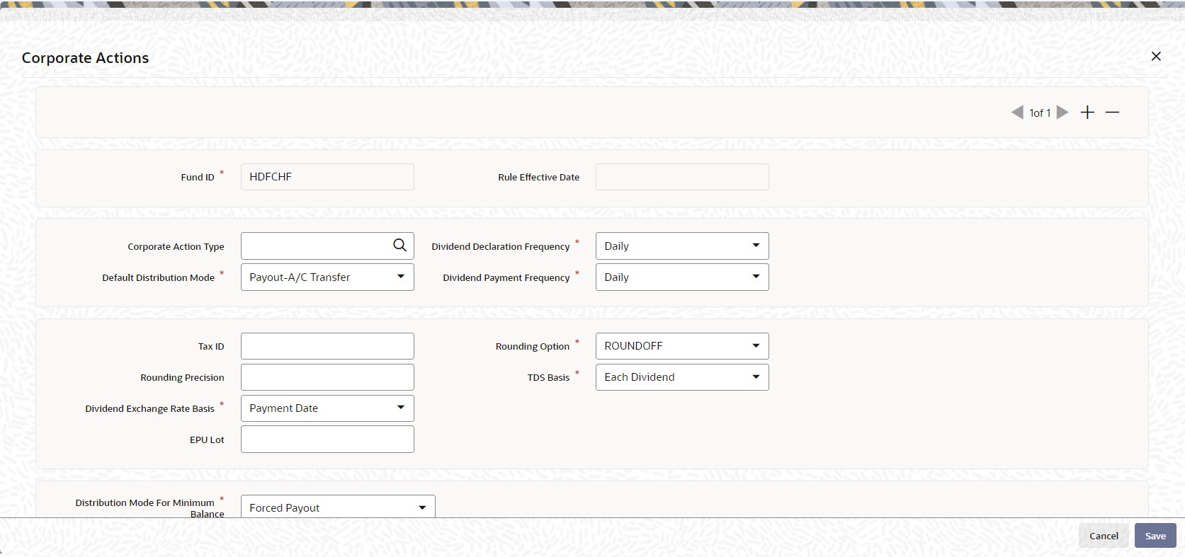

To set up the Corporate Action rules for a fund, use the Corporate Actions screen.
  1. Click Corporate Actions button from the Fund Rules Detail screen.
    The Corporate Actions screen is displayed.
    This screen cannot be used to maintain parameters for corporate actions such as liquidation, split, reverse split and merger. To maintain these, you must use the Corporate Actions Maintenance screen, which you may invoke by clicking on Corporate Actions in the Maintenance menu, and Detail under it.
  2. On Fund Transaction Currencies screen, specify the fields.
    For more information on these corporate actions and the Corporate Actions Maintenance screen, refer the topic Other Fund Activities in this user manual.
    Before you set up a Corporate Actions profile record for a fund, it is desirable to ensure that the fund already has an existing, unauthorized profile record.
    For more information on fields in the screen, refer the below table.
    Table 2-42 Corporate Actions
    Field Description
    Fund ID Display
    This field indicates the ID fund for which you are setting up the Corporate Actions profile. This information is defaulted from the Fund Demographics screen.
    Rule Effective Date Display
    The Rule Effective Date for the fund, which you specified in the Fund Demographics screen, is displayed here.
    Corporate Action Type Alphanumeric; 1 Character; Optional
    Select the type of corporate action for which this rule is being set up. It could be either a cash dividend or a stock dividend. It could be either a cash dividend for income, or capital gains earnings.
    For stock dividends, the following information is accepted by default:
    • The TDS Basis field has a default specification, Tax-exempt, and the field is locked for data entry
    • The option Restrict IDS for Unit Holder is selected and cannot be changed
    • The Default Distribution Mode field has the option Reinvestment selected, and is locked for data entry.
    Dividend Declaration Frequency Mandatory
    Select the frequency with which the dividend is to be declared from the drop-down list. The list displays the following values:
    • Daily
    • Bi-Weekly
    • Half-Yearly
    • Monthly
    • Quarterly
    • Weekly
    • Yearly
    Default Distribution Mode Mandatory
    If the Income Distribution Setup for the unit holder has not yet been specified, the fund level default Unit Holder Distribution Mode to be considered for the unit holder can be specified here. Any one of the options from the drop-down list may be chosen. The following values may be entered:
    • Full Payout-A/C Transfer
    • Full Payout-Check
    • Full Reinvestment
    If the rules are being setup for a share class fund for which reinvestment is mandatory, then this field is defaulted to Full Reinvestment and locked for data entry.
    For stock dividends, the option Full Reinvestment is selected here by default, and cannot be changed.
    Dividend Payment Frequency Mandatory
    Select the frequency with which the declared dividends are to be paid from the drop-down list. The list displays the following values:
    • Daily
    • Bi-Weekly
    • Half-Yearly
    • Monthly
    • Quarterly
    • Weekly
    • Yearly
    As the system supports accumulation of dividends, the payment could be for any dividend that has been declared earlier.
    The Dividend Payment Frequency must not be less than Dividend Declaration Frequency.
    Tax ID Alphanumeric; 15 Characters; Optional
    Enter the tax ID for the fund that is being set up..
    Rounding Option Mandatory
    Select the rounding options for the value of the dividend, designated for the fund from the drop-down list. The list displays the following values:
    • Round Up - Choose Round Up to indicate rounding the value at the precision decimal place to the next higher numeral.
    • Round Off - Choose Round Off to indicate normal rounding at the precision decimal.
    • Round Down - Choose Round Down to indicate truncation of the value at the precision decimal place.
    Example
    Let us suppose that the dividend earned by an investor, Mrs. Laurie Klein, in the ABC Growth Fund is 700.679263 currency units, and that this value must be rounded to the 3rd decimal place.
    If you indicate rounding up, then the value reckoned would be 700.680.
    If you indicate rounding off, then, applying normal rounding off rules, the value reckoned would be 700.679.
    If you indicate rounding down or truncation, then the value would be truncated as it is, in the 3rd decimal place, and it would be reckoned as 700.679.
    Rounding Precision Numeric; 5 Characters; Mandatory
    Indicate the maximum number of decimals that would be reckoned for rounding precision, for the dividend. You cannot indicate a precision higher than 6 decimal places.
    Dividend Exchange Rate Basis Mandatory
    Select the basis upon which the exchange rate will be applied for dividend processing from the drop-down list. The list displays the following values:
    • Payment Date
    • Reference Date
    TDS Basis Mandatory
    This is to indicate whether slab should be looked for every dividend payment separately or whether consolidated on a fiscal year basis. Choose one of the options from the drop-down list. The list displays the following values:
    • Each Dividend
    • Fiscal Year
    • Tax Exempt
    For stock dividends, the option Tax –Exempt is selected here by default, and cannot be changed.
    EPU LOT Numeric; 6 Characters; Mandatory if EPU is applicable
    Specify the number of units for which the EPU quote is deemed to be applicable, for the fund.
    Setting up EPU components is not applicable for stock dividends.
    Distribution Mode For Minimum Balance Mandatory
    Indicate how the income derived from the fund is to be distributed, in respect of unit holders whose holdings balance falls below the minimum holdings specified for the fund.
    Select the mode of distribution for minimum balance from the drop-down list. The list displays the following values:
    • Forced Payout - the income is paid out, regardless of the default distribution mode or any income distribution options (IDS) set for the unit holder
    • According to Unit Holder IDS – the income is distributed based on the Income Distribution (IDS) options set for the unit holder
    Units For Freeze Holding Mandatory
    Select the units for freeze holding from the drop-down list. The list displays the following values:
    • All Units As Of Allocation Date
    • Confirmed Units As Of Allocation Date
    • All Units As Of Price Date
    • Confirmed Units As Of Transaction Date
    • All Units As Of Transaction Date
    • All Units As Of Dealing Date
