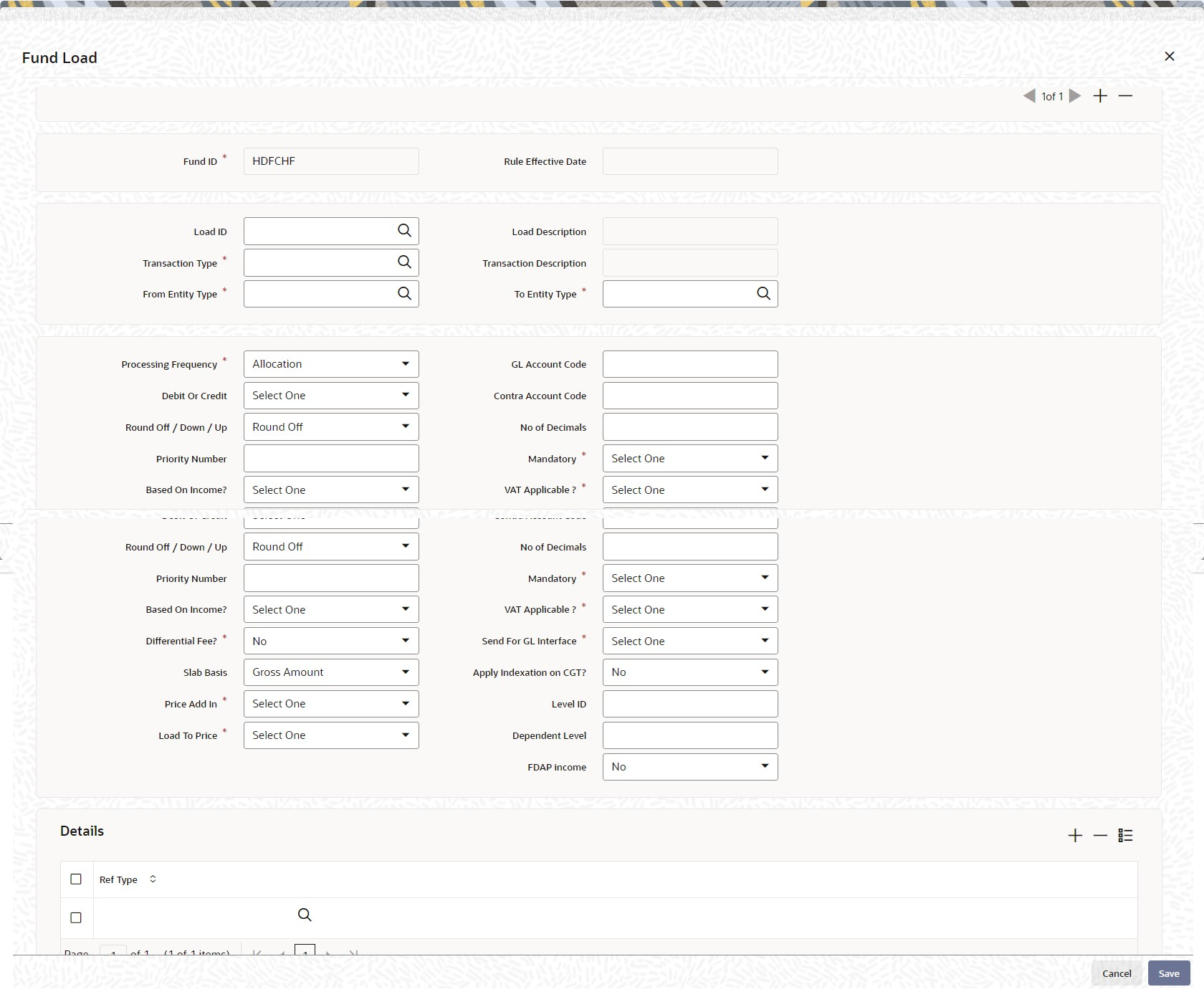

  1. Click Fund Load button from the Fund Rules Detail screen.
    The Fund Load screen is displayed.

  2. On Fund Load screen, specify the fields.
    For more information on fields in the screen, refer the below table.
