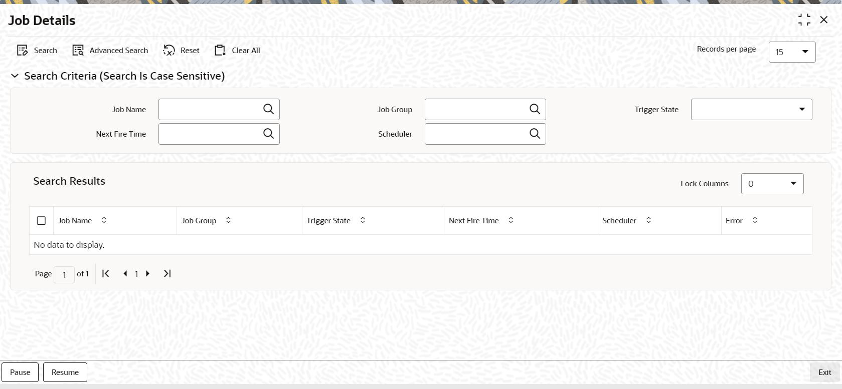

4.9.1 Jobs Details
This topic describes the about the information on controlling the jobs.
  1. On Home screen, type SMSJOBBR in the text box, and click Next.
    The Job Details screen is displayed.
  2. Specify any or all of the details corresponding to the message you want to retrieve.
    The system uses your specifications to as search criteria to query the database and retrieve the record as specified.
  3. On Job Details screen, click New and specify the details.

  4. Click Search button to view the details related to the job. You can pause a job by selecting it and clicking the Pause button. You can resume a paused job by clicking Resume button and the job is scheduled for its next fire time.
