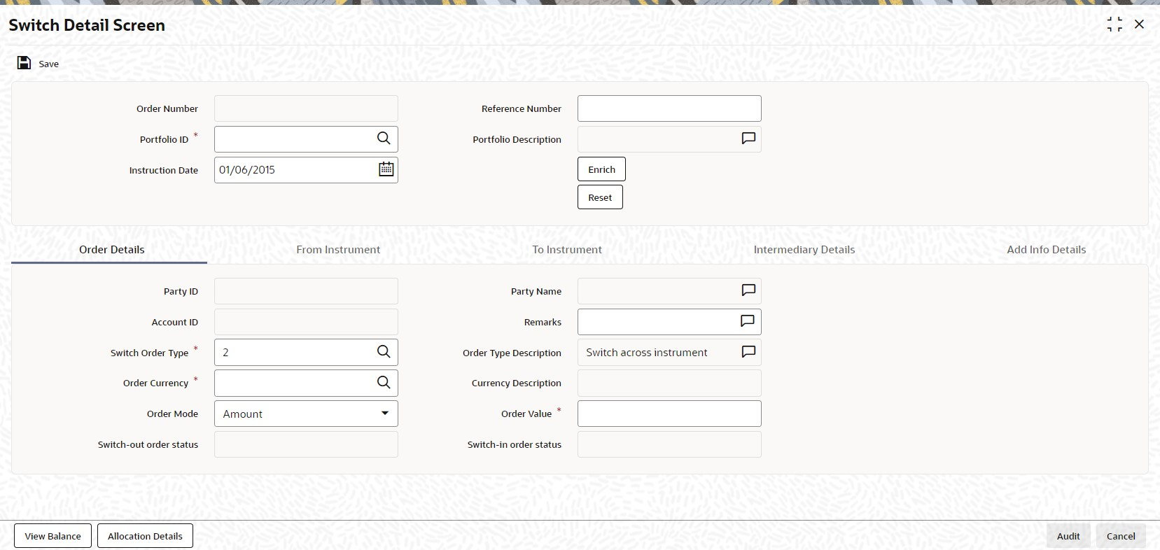

This topic provides the systematic instructions to define payment switch detail in pension module.
  1. On Home screen, type PADSWIDE in the text box, and click Next.
    The Switch Detail screen is displayed.
    Figure 1-109 Switch Detail Screen
  2. On Switch Detail screen, click New to enter the details.
    Table 1-92 Switch Detail - Field Description
    Field Description
    Order Number Display
    The system displays the order number.
    Reference Number Alphanumeric; 16 Characters; Optional
    Specify the reference number,
    Portfolio ID Alphanumeric; 16 Characters; Mandatory
    Specify the portfolio ID. Alternatively, you can select portfolio ID from the option list. The list displays all valid portfolio ID maintained in the system.
    Portfolio Description Display
    The system displays the description of the selected portfolio ID.
    Instruction Date Date Format; Mandatory
    The system defaults the application date. However, you can amend this value to specify the future date.
    Note: Future date cannot be a system holiday. The system does not allow back dated instructions.
  3. If holiday is declared after maintaining a future dated instruction, system will not update the order details automatically.
  4. After specifying the mandatory details, click ‘Enrich’ button. The system displays the party details based on the portfolio ID selected.
