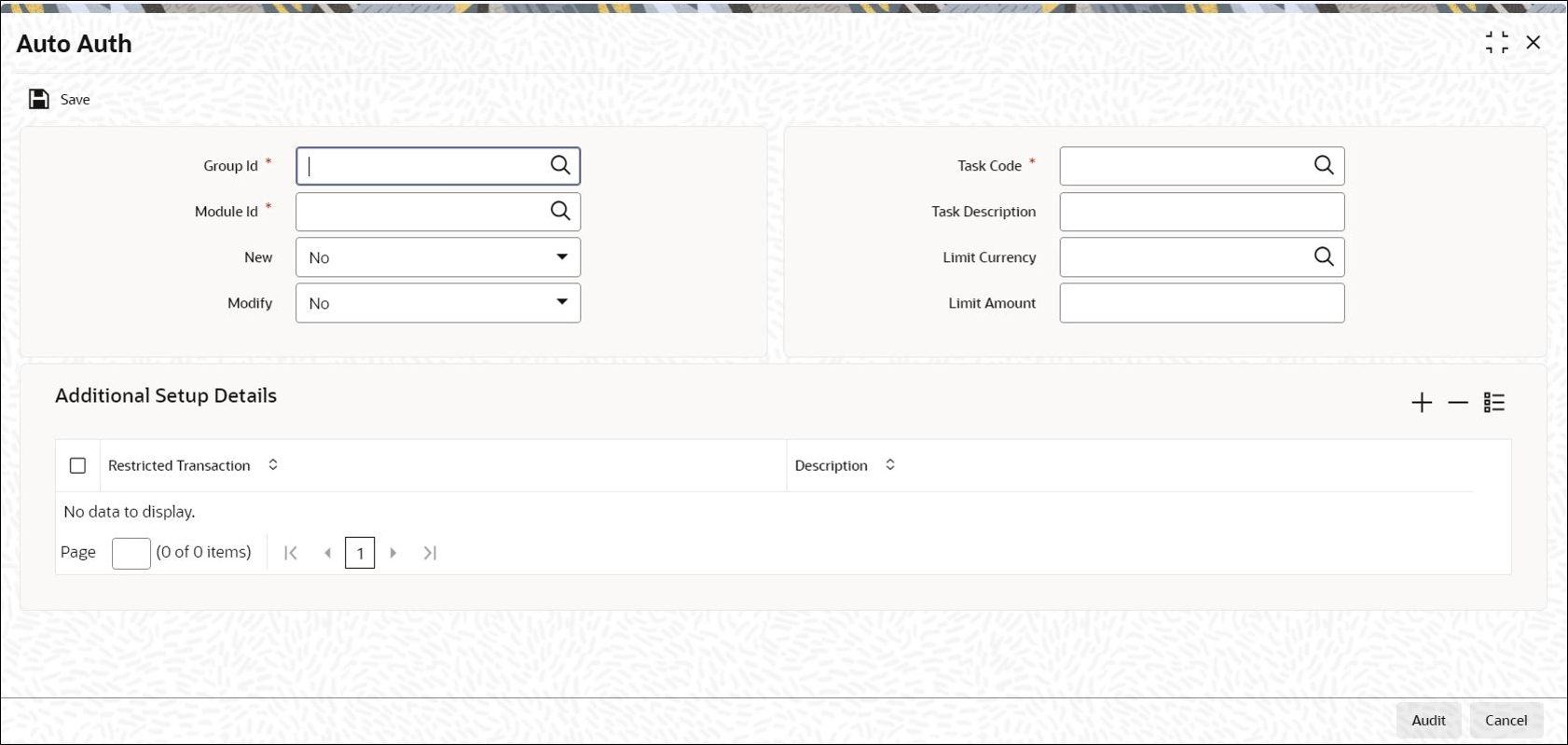

Use Auto Auth screen to allow the auto-authorization feature for a user group and a certain set of menu items.
You must map the user groups to the menu items or the task for which auto-authorization is applicable.
  1. On Home screen, type SMDAUTAU in the text box, and click Next.
    The Auto Auth screen is displayed.
  2. Use this screen to map user groups to the tasks for which auto-authorization is applicable. If the User Administrator or the Module Administrator users do not maintain the setup for each of the user groups in this screen, the auto-authorization is not enabled for that user group.
Enable or Disable Auto-authorization for User Group
  1. Process the Auto Auth screen.
    The auto authorization features that have been enabled for the module and the group to which the logged in user belongs, are displayed.
  2. Click Unlock icon to amend the displayed list.
    The screen is displayed in Amend mode, where you can make your changes. The changes you make will apply to all users and roles in the Group ID to which the logged in user belongs, for the logged in Module.
  3. Make changes as follows to enable auto-authorization:
    1. Select YES in the New field for the task item to enable auto-authorization in the New mode for a task item.
    2. Select YES in the Modify field for the task item to enable auto-authorization in the Amend mode for a task.
    3. Specify the highest volume of the transaction that can be auto-authorized, in the Limit Amount field to set up the volume limit for transaction data entry task items.
    4. You must also indicate the currency in which the volume you have specified is reckoned, in the Limit Currency field. You can indicate a different limit for each role or Group ID, if necessary.
  4. Enable (or disable) the auto-authorization feature for transaction data entry in the following circumstances:
    1. Back dated transactions: Select YES in the Restrict Back Dated Transaction field to disable auto-authorization of backdated transactions in the selected mode. Select NO to enable auto-authorization of backdated transactions in the selected mode.
    2. Transactions in respect of which applicable loads have been overridden: Select YES in the Restrict Load Override Transactions field to disable auto authorization of load override transactions in the selected mode. Select NO to enable auto authorization of load override transactions in the selected mode.
    3. Transactions for which third party payment has been specified: Select YES in the Restrict Third Party Payment Transactions field to disable auto authorization of third party payment transactions in the selected mode. Select NO to enable auto authorization of third party payment transactions in the selected mode
    4. Transactions for which third party delivery has been specified: Select YES in the Restrict Third Party Delivery Transactions field to disable auto authorization of third party delivery transactions in the selected mode. Select NO to enable auto authorization of third party delivery transactions in the selected mode.
  5. Click Save to save your changes when you have finished making the auto-authorization specification for a user group.
    The auto-authorization feature is enabled, and when the user invokes the Save operation in any of the applicable task screens, the entered records are saved as authorized records.
  6. Click Save icon in the Auto Auth screen to enable auto authorization for a user group other than the logged in user group.
    The system displays the message as Do you want to cancel the operation?.
  7. Click OK. The auto authorization record of the logged in user group, which was on display, is closed.
    The Auto Auth screen is opened in New mode.
  8. Select the user group for which you want to enable or disable the auto authorization rights, in the Group ID field.
  9. Select the corresponding module in the Module ID field, and click OK. Subsequently, proceed to set up the auto-authorization rights in the same manner as described above, for the amend operation.
