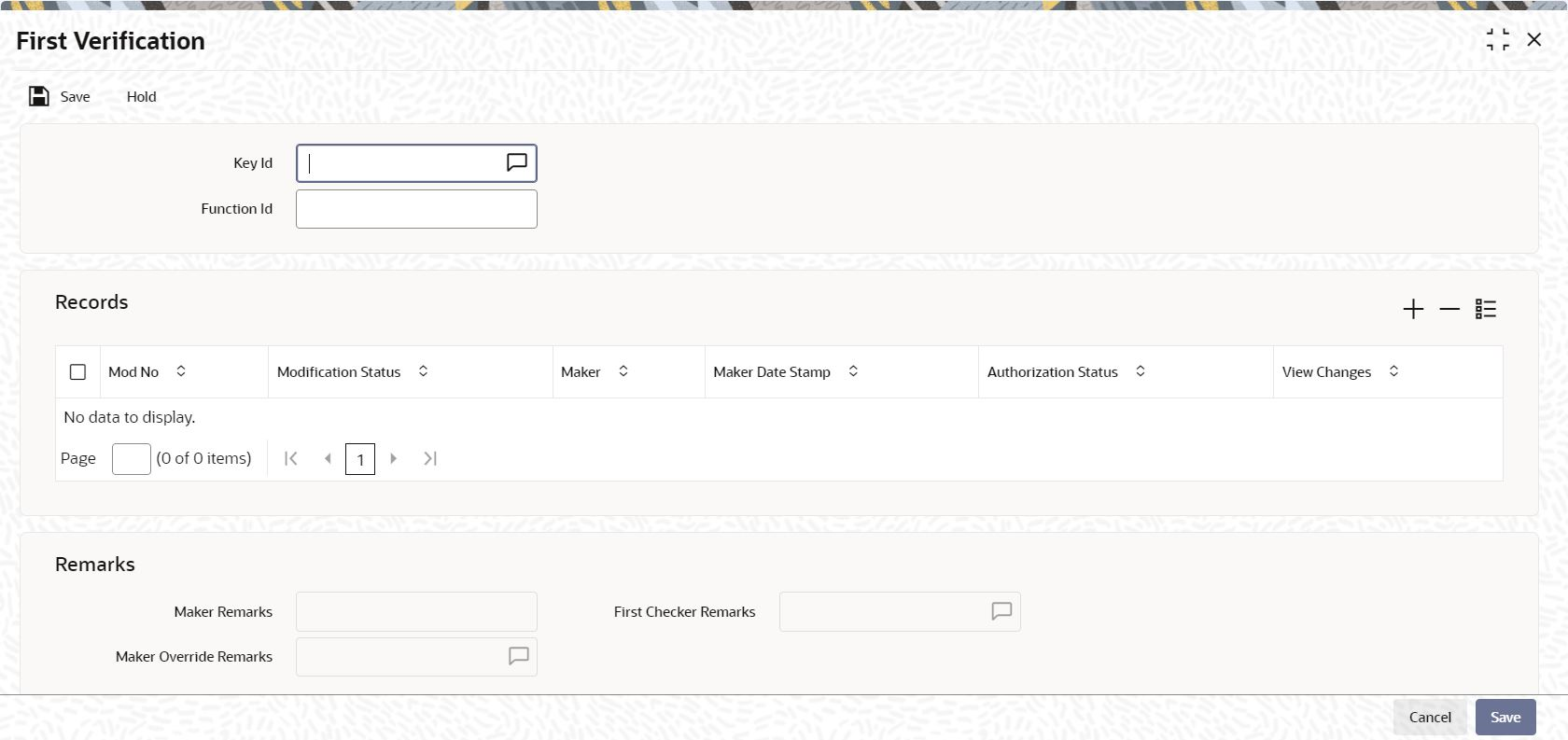

The first level authorization is done using the First Verification screen.
- On Home screen, type CSDVERFY in the text box, and click Next.The First Verification screen is displayed.
- On First Verification screen, click New to enter the details.For more information on fields, refer to the field description table.
Table 3-2 First Verification - Field Description
Field Description Key Id Specify the key identification based on which the record can be queried. Alternatively, you can select the key Id from the option list. This list displays the following values:- Branch - To query the record based on input branch
- Maker ID – To query the record based on maker ID
- Function ID – To query the record based on function ID through which the record was submitted. For example, STDCIF, STDCUSAC
- Key ID – To query the record based on unique key ID
Note: You can search for a specific record using any of the above combination. To authorize a record, you should select the record and click the Accept button.
Branch The system displays the branch for the selected record.
Records The following details pertaining to the records are displayed:- Modification No
- Modification Status
- Maker
- Maker Date Stamp
- Authorization Status
- View Changes
Remarks The following details are captured here.
Maker Remarks The remarks entered by the maker of the record are displayed here.
First Checker Remarks Specify remarks if any as part of first level authorization.
Maker Override Remarks The Override remarks entered by the maker of the record are displayed here.
Warnings The system displays the error or warning codes for which dual authorization is enabled.
Warning Code The warning code is displayed here.
Warning Description The warning message or override messages logged for the record is displayed here.
Fields The following details are captured here:
Field Name The field name is displayed here.
Old Value The old value of the field is displayed here.
New Value The new value of the field is displayed here.
- Click the View Changes button for every record which will start the Function ID screen and highlights the changes.
