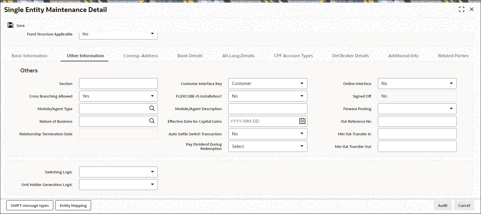

2.4.2 Other Information Tab
This topic explains the other information tab of Single Entity Maintenance Detail.
- On Single Entity Maintenance Detail screen, click Other Information tab to enter the details.The Other Information details are displayed.
Figure 2-5 Single Entity Maintenance Detail_Other Information Tab
- On Other Information Tab, specify the fields.For more information on fields, refer to the field description table.
