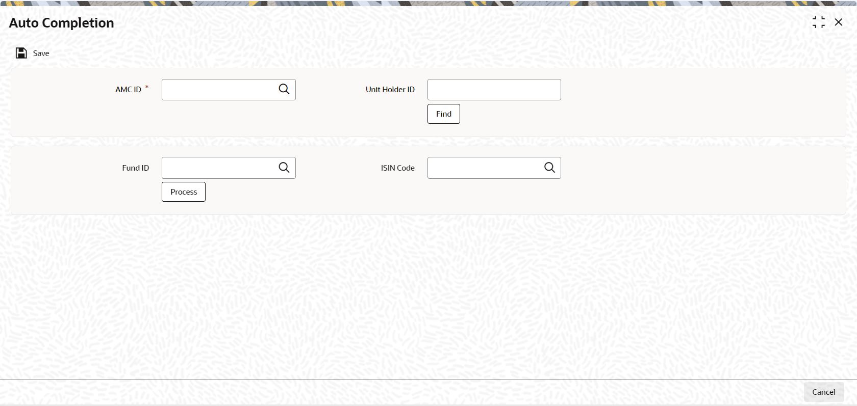

  1. On Home screen, type UTDAUTCO in the text box and click Next.
    The Auto Completion screen is displayed.
  2. On Auto Completion screen, specify the fields.

    Field Description
    AMC ID Alphanumeric; 12 Characters; Mandatory
    Specify the AMC ID of the transactions for which the status needs to be marked as completed. Alternatively, you can select AMC ID from the option list. The list displays all valid AMC ID maintained in the system.
    Unit Holder ID Alphanumeric; 12 Characters; Optional
    Specify the fund along with AMC in case all the transaction under that AMC and fund combination status needs to be marked as completed. Alternatively, you can select fund ID from the option list. The list displays all valid fund ID maintained in the system.
    Fund ID Alphanumeric; 6 Characters; Optional
    Specify the fund ID in which the requested transaction is to be put through. Alternatively, you can select fund ID from the option list. The list displays all valid fund ID maintained in the system.
    ISIN Code Alphanumeric; 25 Characters; Optional
    The system displays the ISIN code if you have specified the fund ID. Else specify the ISIN code.
    If you specify the ISIN code, the system displays the fund ID and vice versa.
