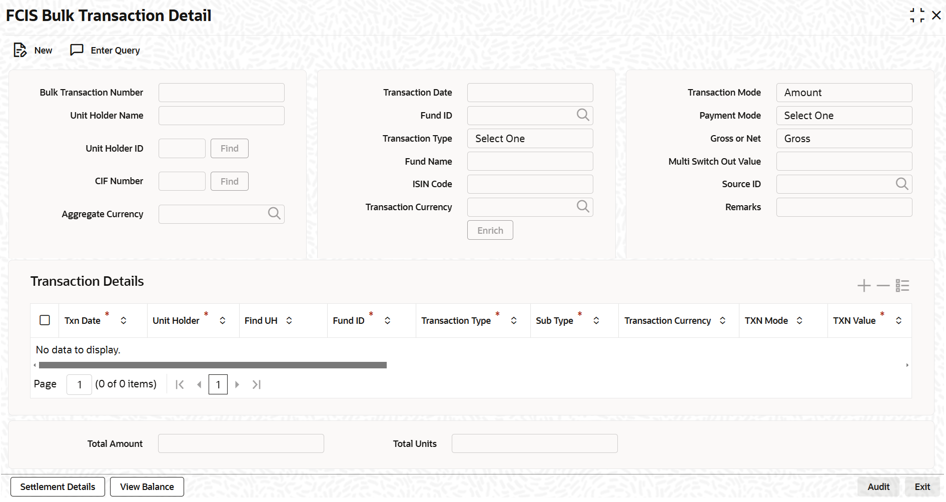

  1. On Home screen, type UTDTXNB in the text box and click Next.
    The FCIS Bulk Transaction Detail screen is displayed.
    Figure 3-18 FCIS Bulk Transaction Detail
  2. On FCIS Bulk Transaction Detail screen, specify the fields.
    Table 3-22 FCIS Bulk Transaction Detail
