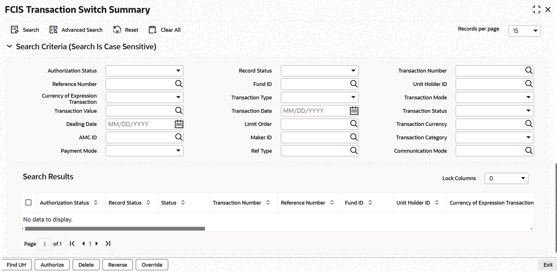

Retrieve a Record in FCIS Transaction Switch Summary
  1. On Home screen, type UTSTXN04 in the text box and click Next.
    The FCIS Transaction Switch Summary screen is displayed.
    Figure 3-80 FCIS Transaction Switch Summary
  2. On FCIS Transaction Switch Summary screen, specify any or all of the following details in the corresponding fields:
    • Authorization Status - If you choose the status, then the records matching the specified status are retrieved. If you do not choose any option, then all the records are retrieved.
    • Record status
    • Transaction Number
    • Fund ID
    • Currency of Expression Transaction
    • Transaction Mode
    • Dealing Date
    • Transaction Currency
    • Maker ID
    • Payment Mode
    • Communication Mode
    • Unit Holder ID
    • Transaction Type
    • Transaction Value
    • Transaction Status
    • Limit Order
    • AMC ID
    • Transaction Category
    • Ref Type
  3. Click Search button to view the records.
    All the records with the specified details are retrieved and displayed in the lower portion of the screen.
