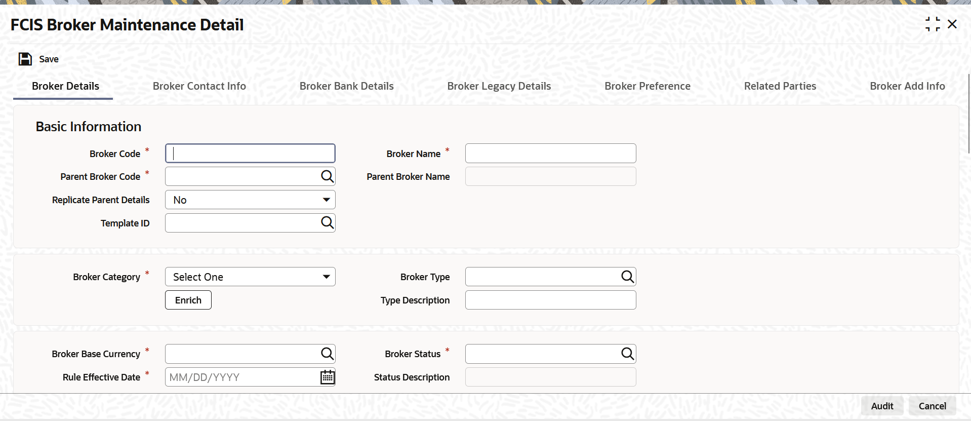

- On FCIS Broker Maintenance Detail screen, click Broker Details tab.The Broker Details are displayed.
Figure 4-4 FCIS Broker Maintenance Detail_Broker Details Tab
- On the Broker Details tab, specify the fields.For more information on fields, refer to the field description table.
