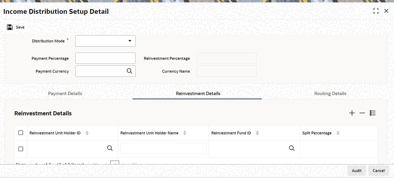

3.1.2 Reinvestment Details Tab
This topic explains the reinvestment details tab of Income Distribution Setup Detail screen.
- On Income Distribution Setup Detail screen, click Reinvestment Details tab.The Reinvestment Details are displayed.
Figure 3-3 Income Distribution Setup Detail_Reinvestment Details Tab
- On the Reinvestment Details tab, specify the fields.For more information on fields, refer to the field description table.
