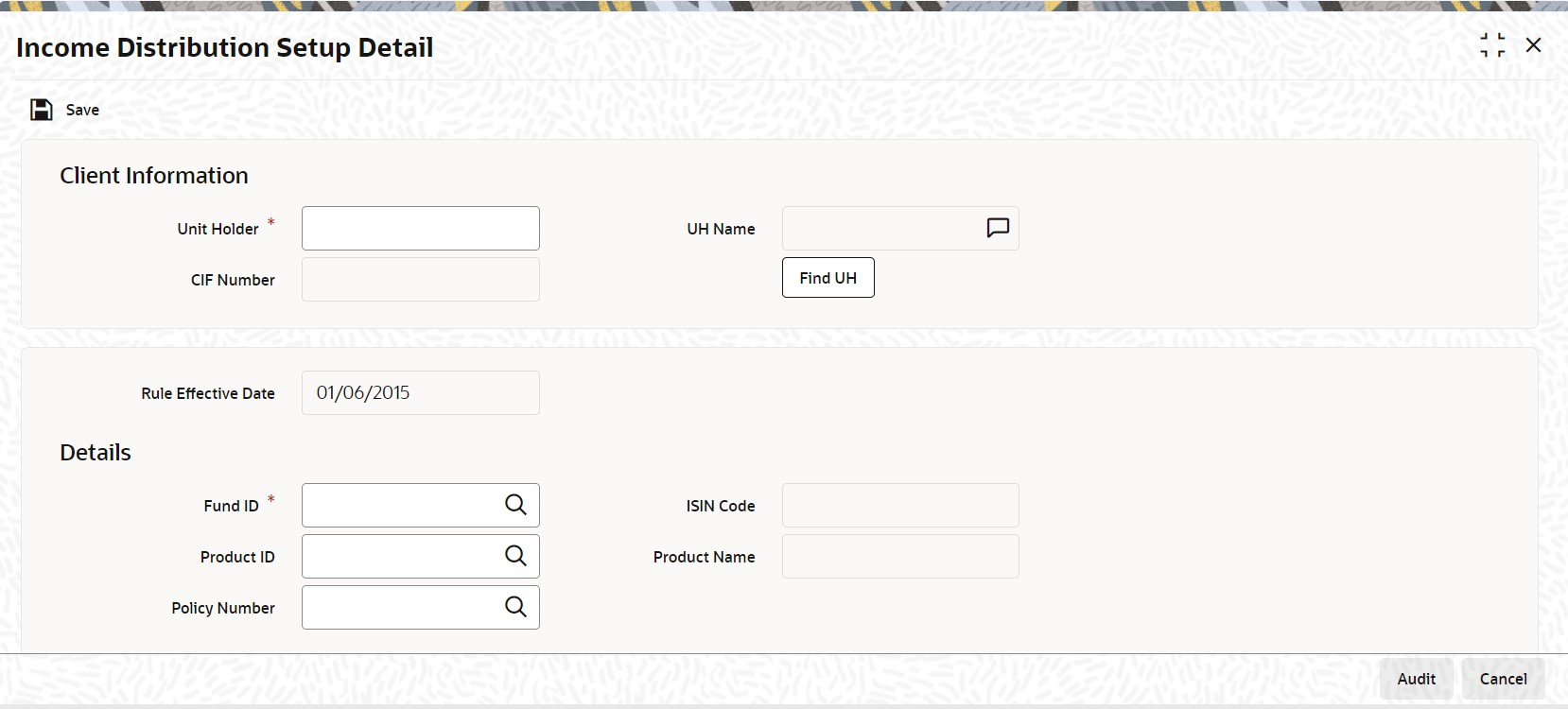

| Client Information | Select the ID of the unit holder for whom you are creating an income distribution setup record in this section. |
| Unit Holder | Alphanumeric; 12 Characters; Mandatory Select the CIF unit holder for whom you are creating an income distribution setup record from the list. |
| CIF Number | Display The system displays the number of the CIF Account under which the unit CIF Number is displayed when you select/ locate a unit holder by clicking Find UH button. |
| UH Name | Display The system displays name of the unit holder. Click Find UH button to query for unit holder details. |
| Rule Effective Date | Date Format; Mandatory Select rule effective date from the adjoining calendar. |
| Details | In this section, you can indicate the fund, policy and product, the income earnings from which will be distributed according to the IDS options you are creating for the selected unit holder. Various combinations at which the Unitholder IDS options can be set up, in order of preference are: Product + Policy + Fund level Product + Fund level In case of LEP transactions, if the UH IDS is not available, the dividend earnings will be reinvested into the default reinvestment fund maintained for the product in the Product Maintenance Detail screen. However, if the reinvestment fund is not defined, then the dividend is reinvested into the source fund itself. You can also indicate the manner in which the income must be distributed. |
| Fund ID | Alphanumeric; 6 Characters; Mandatory Select the ID of the fund from which the selected investor derives income, which will be distributed according to the IDS options you are creating in this screen. If the selected investor receives income from many funds, then you must create the IDS options for the income from each fund in this screen as applicable, if so requested by the investor. When you specify the ID of the fund, the ISIN code of the fund is displayed in the ISIN Code field. |
| ISIN Code | Display The system displays the ISIN Code for the selected Fund ID. |
| Product ID | Alphanumeric; 10 Characters; Optional Select the ID of product from which the investor derives income, which will be distributed according to the IDS options you are creating in this screen. This field is not applicable if you are setting up IDS options for UT transactions. |
| Product Name | Display The system displays the name of the product for the selected product ID. |
| Policy Number | Alphanumeric; 16 Characters; Optional Select the policy from which the investor derives income, which will be distributed according to the IDS options you are creating in this screen. This field is not applicable if you are setting up IDS options for UT transactions. |
