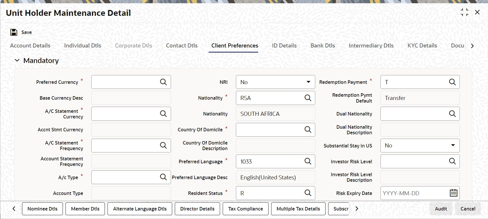

2.2.5 Client Preferences Tab
This topic provides the systematic instructions to specify the client preferences for corporate investors in the Unit Holder Maintenance Detail screen.
- On Unit Holder Maintenance Detail screen, click Client Preferences tab.The Client Preferences details are displayed.
Figure 2-6 Unit Holder Maintenance Detail_Client Preferences Tab
- On the Client Preferences tab, specify the fields.For more information on fields, refer to the field description table.
Table 2-8 Client Preferences - Field Description

If multiple stop codes are mapped to the unit holder, the highest stop account restriction will be considered for the unit holder status and the system will display the warning message as Unit Holder is mapped with the stop account code at transaction level.
Stop Code Description Display
The system displays the description for the selected stop code.
Stop Account Reason Alphanumeric; 255 Characters; Optional
Specify the reason for stopping an account.
Stop Account Effective Date Date Format; Optional
Specify the effective date to stop an account.
The stop code effective date can be a future dated. However, the system will validate only those stop codes which has the effective date less than or equal to the application date and lesser than release date for current transactions. The system will not validate the stop codes which has effective date greater than the application date.
For backdated transactions,- In case of single stop code for the UH, the system will pick up the stop account restriction applicable for that period of time. However, in case of multiple stop codes, based on the transaction type (whether IPO, Subscription, Redemption etc), the system will check each bit for the respective stop codes available for that time and will take the highest preference stop account restriction.
- For both single and multiple stop codes, the system will pick up the stop account restriction if the transaction date is greater than or equal to the stop account effective date but less than the stop account release date.
The system will not allow you to add any stop code effective date for the backdated and display an error message as Stop Code effective date cannot be a backdated.
Stop Account Release Date Date Format; Optional
Specify the stop account release date.
Note: Stop code will remain available in the system and will not be made to null.
Stop Account Optional
Select stop account status from the adjoining drop-down list. Following are the options available:- Yes
- No
Stop Account Restrictions Display
The stop account restrictions box gets populated with according to the stop code mapped to UH.
Client Communication Restrictions The section displays the following fields.
Contract Notes Optional
Select if contract notes are applicable or not from the adjoining drop-down list. Following are the options available:- Applicable
- Not Applicable
Account Statement Optional
Select if account statement is applicable or not from the adjoining drop-down list. Following are the options available:- Applicable
- Not Applicable
Communication Mode Restrictions The section displays the following fields.
Communication Mode Alphanumeric; 2 Characters; Optional
Specify the communication mode. The adjoining option list displays all valid communication mode maintained in the system. You can choose the appropriate one.
For communication mode, the system will restrict the param value to the length of 2 characters.
The system will validate the applicable communication mode in UH screen against the communication mode in the transaction screen.
Communication Mode Description Display
The system displays the description for the selected communication mode.
Restriction Optional
Select if restriction is applicable or not from the adjoining drop-down list. Following are the options available:- Applicable
- Not Applicable
Once the communication mode is restricted, the system will not allow you to enter the trades using the specific communication mode including uploads and will display an error message as The communication mode is restricted for the UH.
If you try to map the restricted communication mode again to the UH then the system will display an error message as Communication mode is already restricted for the UH.
If you try to capture the transaction for the UH where the defined communication mode is restricted, then the system will display an error message as Communication mode is restricted for the UH.
Beneficiary Payout You can direct redemption and dividend proceeds to beneficiaries by specifying the following preferences
Redemption Payout Optional
Check this option to indicate that the proceeds of a redemption transaction should be transferred to the beneficiaries mentioned. If you select this option, you need to maintain a minimum of one beneficiary along with the percentage to be awarded for the beneficiary in the Beneficiary Dtls screen. It is also essential that the beneficiary be an existing Unit Holder and not a third party beneficiary.
Dividend Payout Optional
Check this option to indicate that dividends should be transferred to the beneficiaries specified. If you select this option, you need to maintain a minimum of one beneficiary along with the percentage to be awarded for the beneficiary in the Beneficiary Dtls screen. It is also essential that the beneficiary be an existing unitholder and not a third party beneficiary.
When you have multiple beneficiaries for a payout (dividend or redemption), you can amend the percentage to be given to each, as and when required. If the total percentage awarded to the beneficiaries does not add up to 100%, the remaining payout will be done to the primary unitholder. The amount paid out to the beneficiary will be net of withholding tax, which will be derived on the basis of the tax for the unitholder – Beneficiary Country combination.
Parent topic: Process Unit Holder Maintenance Detail
