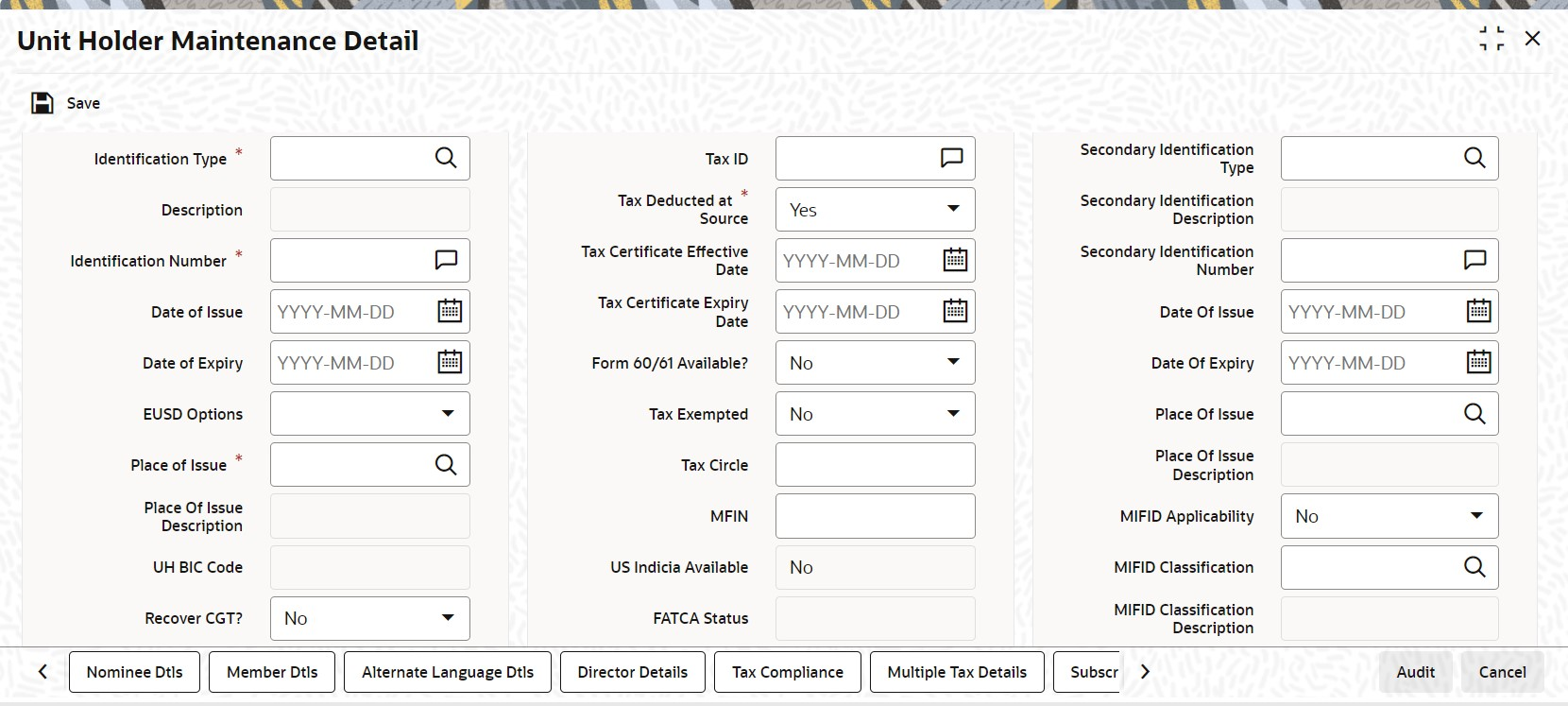

2.2.6 ID Details Tab
This topic provides the systematic instructions to specify the ID details for corporate investors in the Unit Holder Maintenance Detail screen.
- On Unit Holder Maintenance Detail screen, click ID Details tab.The ID Details are displayed.
Figure 2-7 Unit Holder Maintenance Detail_ID Details Tab
- On the ID Details tab, specify the fields.For more information on fields, refer to the field description table.
