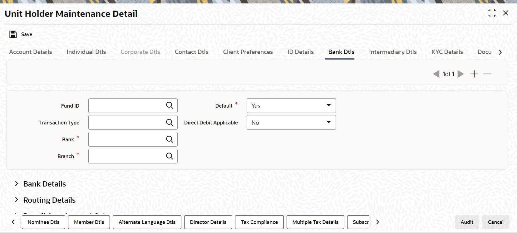

  1. On Unit Holder Maintenance Detail screen, click Bank Dtls tab.
    The Bank Details are displayed.
    Figure 2-8 Unit Holder Maintenance Detail_Bank Details Tab
  2. On Bank Dtls tab, specify the fields.

    Fund ID
    Alphanumeric; 6 Characters; Optional
    Select the ID of the fund.
    Transaction Type
    Alphanumeric; 3 Characters; Optional (Mandatory if Fund ID is specified)
    Specify the type of transaction. Alternatively, you can select the transaction type from the option list. The list displays all valid transaction type maintained in the system.
    • If no IDs is maintained for the Unit Holder, then system will take the banking instructions for dividend payment maintained at Unit Holder Maintenance Detail screen (UTDUH).
    • If no Dividend Payment banking instructions is maintained for the Unit Holder in Unit Holder Maintenance Detail screen (UTDUH) then the system will take the banking instructions for All transaction types/funds.
    Bank
    Alphanumeric; 12 Characters; Mandatory
    Select the name of the bank in which the account is held from the list.
    Branch
    Select the name of the branch of the bank in which the account is held from the list.
    Default
    Mandatory
    Use this check box to identify the bank account that is to be reckoned as the default bank account for the investor in the system. In the desired row, check this box.
    Note: For HSBC customers, accounts for a specific currency and payment type combination can be marked as default accounts only if they are maintained for All funds and All transaction types. Also, for a currency where the default has already been specified, other accounts maintained for specific funds and specific transaction types for the same currency cannot be designated as the default account for that currency.
    In case the default account for a particular payment type and currency combination has not been maintained and you designate an account maintained for a specific fund and transaction type as the default account, the system displays the following message (at the time of saving unit holder details) Default accounts can be maintained only for fund All and transaction type All.
    For Default Account Maintenance for various Currency and Payment Type, refer to the table Table 2-11.
    Direct Debit Applicable
    Optional
    Select Yes to indicate if whether direct debits are allowed for the account.
