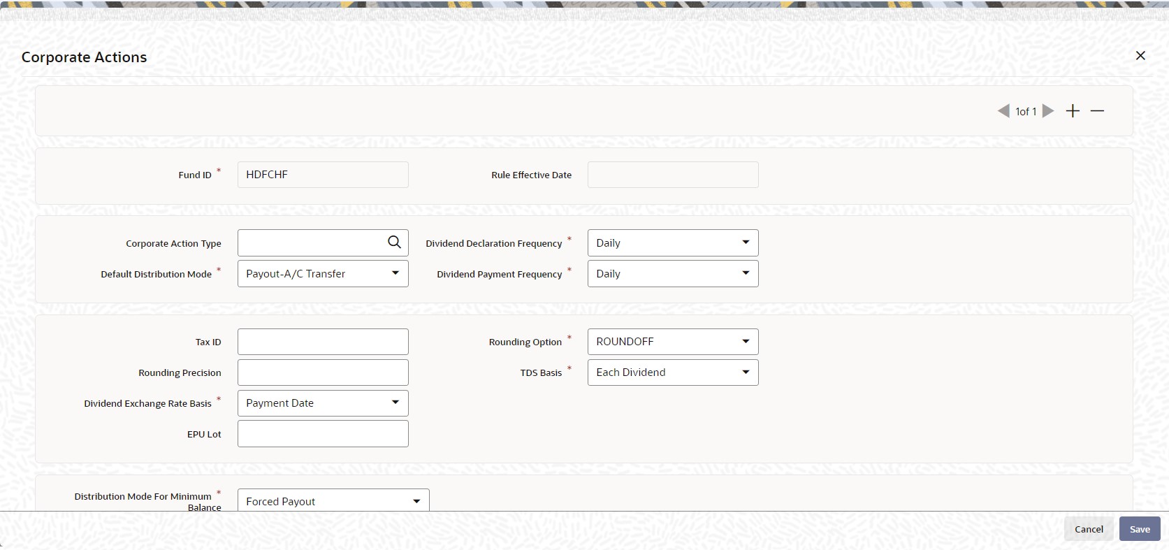

2.1.10 Corporate Actions
This topic provides information on corporate actions button.
This fund rule facilitates the definition of the guidelines that will govern the distribution of income derived from the fund by the unit holders that subscribe to the fund. You can define the framework according to which corporate actions such as dividend declaration and processing must be performed for a fund. Through this screen the system can also process multiple distributions of a fund on the same day and process the distribution on the same day.
To set up the Corporate Action rules for a fund, use the Corporate Actions screen.
- Click Corporate Actions button from the Fund Rules Detail screen.The Corporate Actions screen is displayed.
This screen cannot be used to maintain parameters for corporate actions such as liquidation, split, reverse split and merger. To maintain these, you must use the Corporate Actions Maintenance screen, which you may invoke by clicking on Corporate Actions in the Maintenance menu, and Detail under it. - On Fund Transaction Currencies screen, specify the fields.
For more information on these corporate actions and the Corporate Actions Maintenance screen, refer the topic Other Fund Activities in this user manual.
Before you set up a Corporate Actions profile record for a fund, it is desirable to ensure that the fund already has an existing, unauthorized profile record.For more information on fields in the screen, refer the below table.
Table 2-42 Corporate Actions
Field Description Fund ID Display This field indicates the ID fund for which you are setting up the Corporate Actions profile. This information is defaulted from the Fund Demographics screen.
Rule Effective Date Display The Rule Effective Date for the fund, which you specified in the Fund Demographics screen, is displayed here.
Corporate Action Type Alphanumeric; 1 Character; Optional Select the type of corporate action for which this rule is being set up. It could be either a cash dividend or a stock dividend. It could be either a cash dividend for income, or capital gains earnings.

Dividend Declaration Frequency Mandatory Select the frequency with which the dividend is to be declared from the drop-down list. The list displays the following values:

Default Distribution Mode Mandatory If the Income Distribution Setup for the unit holder has not yet been specified, the fund level default Unit Holder Distribution Mode to be considered for the unit holder can be specified here. Any one of the options from the drop-down list may be chosen. The following values may be entered:

Dividend Payment Frequency Mandatory Select the frequency with which the declared dividends are to be paid from the drop-down list. The list displays the following values:

Tax ID Alphanumeric; 15 Characters; Optional Enter the tax ID for the fund that is being set up..
Rounding Option Mandatory Select the rounding options for the value of the dividend, designated for the fund from the drop-down list. The list displays the following values:

Rounding Precision Numeric; 5 Characters; Mandatory Indicate the maximum number of decimals that would be reckoned for rounding precision, for the dividend. You cannot indicate a precision higher than 6 decimal places.
Dividend Exchange Rate Basis Mandatory Select the basis upon which the exchange rate will be applied for dividend processing from the drop-down list. The list displays the following values:

TDS Basis Mandatory This is to indicate whether slab should be looked for every dividend payment separately or whether consolidated on a fiscal year basis. Choose one of the options from the drop-down list. The list displays the following values:

Distribution Mode For Minimum Balance Mandatory Indicate how the income derived from the fund is to be distributed, in respect of unit holders whose holdings balance falls below the minimum holdings specified for the fund.
Select the mode of distribution for minimum balance from the drop-down list. The list displays the following values:

Units For Freeze Holding Mandatory Select the units for freeze holding from the drop-down list. The list displays the following values:

Dividend Payment Numeric; 5 Characters; Optional Enter a lead-time in days. The Registrar must enter the Dividend Payment Date within this lead-time, from the time the dividend information is declared.
Each of the lead times must be less than the Dividend Declaration Frequency. For example, if the Dividend Declaration Frequency is WEEKLY, the Board Meeting Lead Time cannot be 8 days.
NPI Preferences
Table 2-46 Corporate Actions - NPI Preferences
Field Description NPI Applicable Mandatory Select Yes from drop-down list to indicate that non permissible income (NPI) component is allowed for this fund.
NPI Payment Alphanumeric; 3 Characters; Optional If NPI is applicable for this fund, then specify the default payment option from the drop-down list provided.
Override Unitholder Preference? Mandatory if NPI is applicable Select Yes from drop-down list if the fund override the NPI payment preferences maintained for the investor at the unit holder level. However, if the NPI payment preferences are not maintained at the unitholder level, then NPI payment will be made as per the fund preferences.
Force Reinvestment of Uncleared units Numeric; 1 Character; Mandatory if NPI is applicable The system does not consider NPI amount while processing reinvestments, even if it is from un-cleared balances. It should either be paid to a trust or to the unit holder.
However, in case of Permissible income, you can opt to reinvest the Un-cleared Unit balances by choosing the Force reinvestment option. Else, select No preference, which overrides the UH IDS setup.
Multiple Distribution
Table 2-47 Corporate Actions - Multiple Distribution
Field Description Net/Gross Optional Select Net or Gross from the drop-down list.
Multiple Distribution Optional Select if different types of distributions can be processed on the same day or not from the adjoining drop-down list. Following are the options available:
- Yes
- No
Table 2-48 Corporate Actions - Multiple Distribution
Field Description Distribution Type Alphanumeric; 3 Characters; Mandatory (if multiple distribution box is checked.) This field is enabled if the Multiple Distribution is selected as Yes box is selected. Select the appropriate value from the drop-down list. The options available are INT (Interest), DIV (dividend), and PID (Property Income Distribution). This distribution is applicable for corporate action type Cash only.
Distribution Value Display The system displays the description for the selected distribution type.
- Dividend Processing for Fund
This topic provides information on dividend processing for fund details.
Parent topic: Fund Rule
