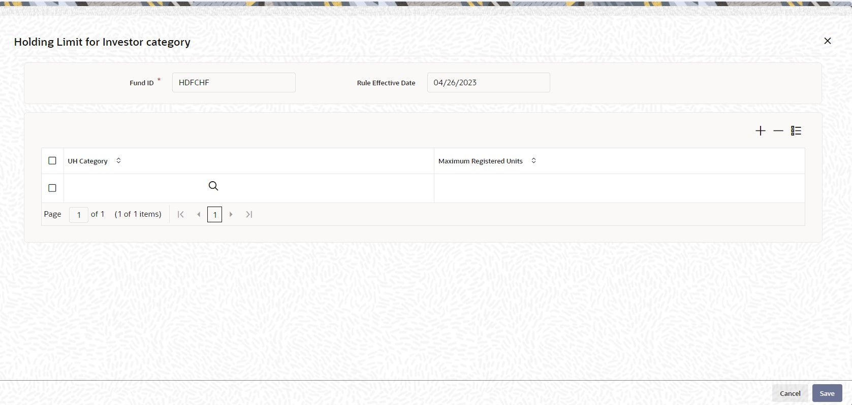

  1. Click Holding Limit for Investor Category button from the Share Characteristics screen.
    The Holding Limit for Investor Category screen is displayed.
    Figure 2-4 Holding Limit for Investor Category
  2. On Holding Limit for Investor Category screen, specify the fields.
    For more information on fields in the screen, refer the below table.
    Table 2-8 Holding Limit for Investor Category
    Field Description
    Fund ID Display
    This field indicates the ID fund for which you are setting up the Shares Characteristics profile. This information is defaulted from the Fund Demographics screen.
    Rule Effective Date Display
    The Rule Effective Date for the fund, which you specified in the Fund Demographics screen, is displayed here.
    UH Category Alphanumeric; 2 Characters; Mandatory
    Enter one of the valid investor categories. During unitholder amendment the system will validate if the amendment breaches the limit set up at the investor category level. System will not allow the amendment if the limits are breached and displays an appropriate error message.
    Maximum Registered Units Numeric; 27 Characters; Optional
    Specify the Maximum Registered Units.
  3. Click Add icon to add details on Investor Category. Similarly you can click Delete icon to delete the details.
