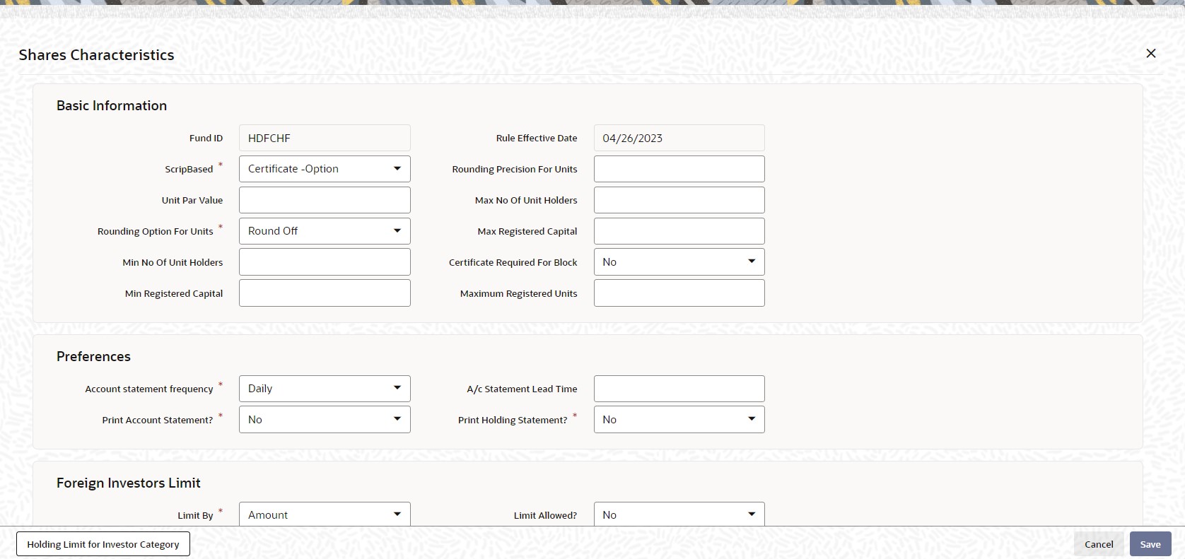

To set up the Shares Characteristics rule for a fund, use the Shares Characteristics screen.
  1. Click Shares Characteristics tab from the Fund Rules Detail screen.
    The Shares Characteristics screen is displayed.
    Figure 2-3 Shares Characteristics
    Before you set up a Shares Characteristics profile record for a fund, it is desirable to ensure that the fund already has an existing, unauthorized Fund Rules profile record.
  2. On Shares Characteristics screen, specify the fields.
