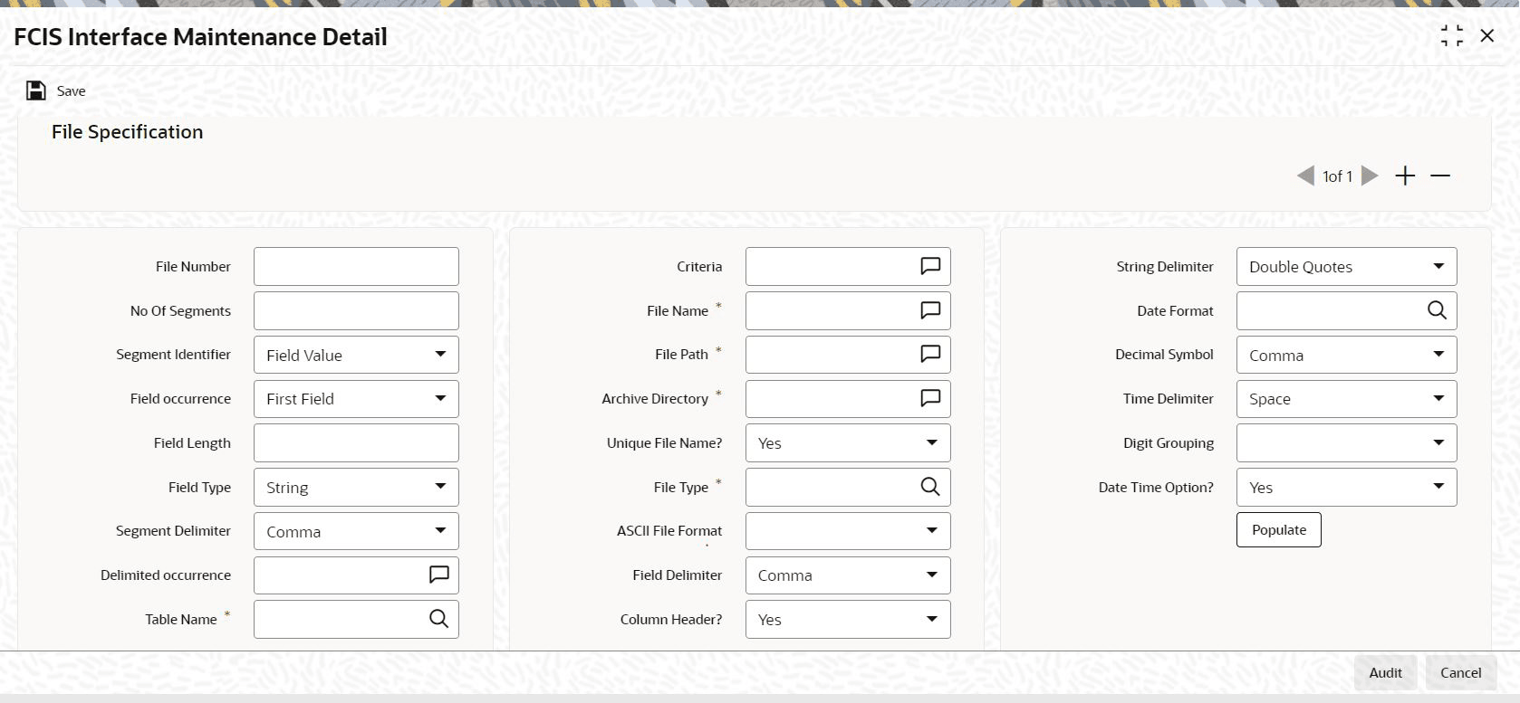

Figure 4-2 File Specification
Description of the illustration fcis-interface-maitenance-detail_1.pngFor more information on fields, refer to the field description table.
Table 4-3 File Specification - Field Description
Field Description Attributes File Number Specify the serial number for the file that is involved in the data exchange. When you add a new file or table name, it is given a new sequential file number.
Numeric; 3 Characters; Mandatory
No of Segments Specify the number of segments to be uploaded.
Numeric; 2 Characters; Optional
Segment Identifier Select the value associated with the segment identifier to be uploaded from the drop-down list. The available options are:- Field Value
- Delimited
Optional
Field Occurrence elect the field corresponding to the segment identifier to be uploaded from the drop-down list. The available options are:- First Field
- Last Field
Optional
Field Length Specify the length of the field to be uploaded.
Field Type Select the type of the field from the drop-down list. The available options are:- String
- Number
Optional
Segment Delimiter Segment delimiter is used only for interface with segments. Select the delimiter to be used for the different segments from the drop-down list. The available options are:- Comma
- Colon
- Semi Colon
- Space
- Tab
- Null String
Optional
Delimited Occurrence Specify the delimited occurrences.
Alphanumeric, 255 Characters; Optional
Table Name Specify the name of the table associated with the specified procedure that will receive imported data or contain the data that is to be exported
The value mentioned here must correspond to a valid database table. You can use the option list to specify a new table name.
Alphanumeric, 30 Characters; Mandatory
Criteria Specify a clause that filters the data that is being exported or imported. For example, you can specify an SQL statement such as a Where clause here. The clause will look for and pick up all data that satisfies the Where clause, in the data that is being exported or imported.
File Name The system displays the name of the file for the selected file ID.
Specify the name of the file that will be involved in the data exchange.- Import - For example, if the specified file name is nav.xls, and unique file name is Yes, only the file nav.xls will be picked up. If not, all files that bear the name nav*.* will be picked up.
- Export - File name generation will be based on the mask value given in the File name of the interface definition.
This field is enabled if you have selected Unique File Name field is selected as No.
For more information on mask values, refer Table 4-4.
Maximum length of the file name will be limited to 100 characters without the extension. If file name length exceeds more than 100, then the system will consider the first 100 characters of file name from the left.
Alphanumeric, 255 Characters; Mandatory
File Path Specify the path in which the specified file will be found. Click the button alongside this field to browse to the desired location.
Archive Directory Specify a location where the specified file may be stored or archived for future reference, after the data is either exported or imported. If you do not specify an archive directory, the file is deleted from the specified File Path once the interface is processed and the data exchange is done.
Unique File Name? Select Yes to indicate that, only files that exactly correspond with the specified file name will be imported/exported. If you choose 'No', all the files that resemble the specified file name will be picked up for import. And for export, the file name generation will be based on the mask value given in the file name of the interface definition.
Optional
File Type Select the type of file that is being exported or imported.
Alphanumeric, 1 Character; Mandatory
ASCII File Format Select the format for ASCII files, either Fixed or Delimited from the drop-down list.
Mandatory for ASCII file types
Field Delimiter Field delimiter is used only for interface without segments. Select the delimiter to be used for the different fields from the drop-down list. The available options are:- Comma
- Colon
- Semi Colon
- Space
- Tab
- Null String
Optional
Column Header Select Yes from the drop-down list if column headings must be picked up in the export or import file, typically in an MS Excel Worksheet.
Optional
String Delimiter Select the delimiter to be used for the different strings from the drop-down list. The available options are:- Double Quotes
- Single Quotes
Optional
Date Format Select the date format from the option list.
Alphanumeric; 12 Characters; Optional
Decimal Symbol Select the decimal symbol from the drop-down list. The available options are:- Comma
- Space
- Dot
- Fixed Length
Optional
Time Delimiter Select the time delimiter from the drop-down list. The available options are:
- Colon
- Semi Colon
- Space
Optional
Digit Grouping Select the digit grouping from the drop-down list. The available options are:
- Comma
- Space
- Dot
Optional
Date Time Option? Select the date-time format that is applicable in the data that is being imported or exported.
Optional

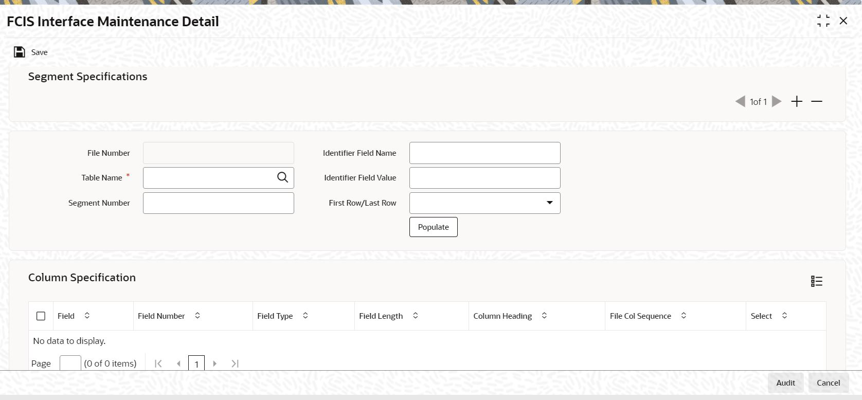

Segment Specifications Specify the fields under this section. NA File Number The system displays the file number.
Display
Table Name Specify the table name.
Alphanumeric; 30 Characters; Mandatory
Segment Number ' Specify the segment number.
Alphanumeric; 3 Characters; Mandatory
Identifier Field Name Specify the identifier field name.
Alphanumeric; 30 Characters; Optional
Identifier Field Value Specify the identifier field value.
First Row/Last Row Select if the segment is first row or last row from the drop-down list. The available options are:- First Row
- Last Row
Optional
Populate Click this button to populate the following details. NA Column Specification Specify the fields under this section. NA Field The system displays the field number. However, you can amend this value.
You can specify the actual columns or fields in the file that will be exported or imported or in the specified table, in the Column Specifications Maintenance screen. You can also define a sequence in which the data must be ordered.
Alphanumeric; 50 Characters; Mandatory
File Number The sequential number for the selected file from the File Specifications Tab grid in the Interface Maintenance screen is displayed here. It represents the file for which you are specifying the column details in this screen. All the columns that are found in the specified table are displayed in the grid in this screen, with their details. Making changes to any of these details will result in a corresponding change in the output data. If you delete a particular row in the grid, then that column will not appear in the output data.
Field Type The system displays the field type. However, you can amend this value.
Field Length The system displays the field type. However, you can amend this value.
