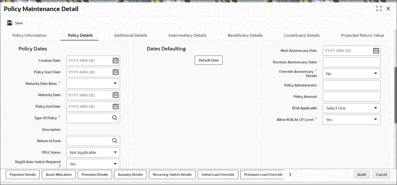

2.1.2 Policy Details Tab
This topic explains the policy details tab of Policy Maintenance Detail screen.
  1. On Policy Maintenance Detail screen, click Policy Details tab to enter the details.
    The Policy details are displayed.
    Figure 2-3 Policy Maintenance Detail_Policy Details Tab
  2. On Policy Details tab, specify the fields.
    Table 2-5 Policy Details - Field Description
    Field Description
