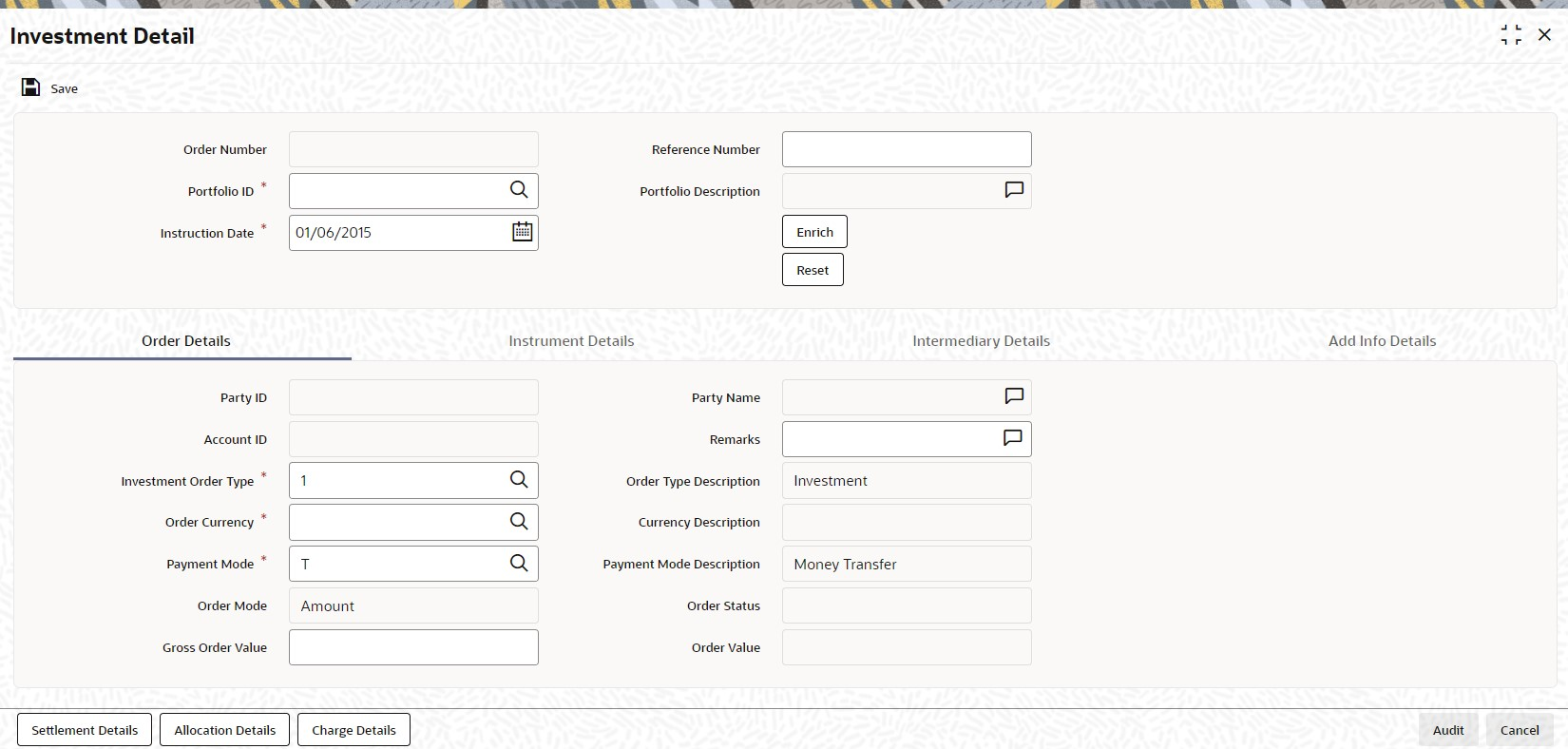

1.58.1 Order Details Tab
This topic explains the Order Details of Investment Detail screen.
  1. On Investment Detail screen, click Order Details tab to view the following details.
    The Order Details are displayed.
  2. On the Order Details tab, specify the fields.
    Table 1-74 Order Details - Field Description.
    Field Description
    Party ID Display
    The system displays the party ID based on the portfolio ID selected.
    Party Name Display
    The system displays the name of the party based on the portfolio ID selected.
    Account ID Display
    The system displays the account number of the party based on the portfolio ID selected.
    Remarks Alphanumeric; 255 Characters; Optional
    Specify remarks, if any.
    Investment Order Type Alphanumeric; 3 Characters; Mandatory
    Specify the investment order type. Alternatively, you can select investment order type from the option list. The list displays all valid investment order type maintained in the system.
    Order Type Description Display
    The system displays the description of the selected investment order type.
    Order Currency Alphanumeric; 3 Characters; Mandatory
    Specify the order currency code. Alternatively, you can select the currency code from the option list. The list displays all valid currency code maintained in the system.
    Currency Description Display
    The system displays the description of the selected order currency code.
    Payment Mode Alphanumeric; 2 Characters; Mandatory
    Specify the mode of payment. Alternatively, you can select the payment mode from the option list. The list displays all valid payment mode maintained in the system.
    Payment Mode Description Display
    The system displays the description of the selected payment mode.
    Order Mode Display
    The system displays the mode or order.
    Order Status Display
    The system displays the status of the order.
    Gross Order Value Numeric; 30 Characters; Mandatory
    Specify the gross order value.
    Order Value Display
    The system displays the net amount.
    The system calculates the order value as follows:
    Order Value = Gross Order Value -Pension Charge
