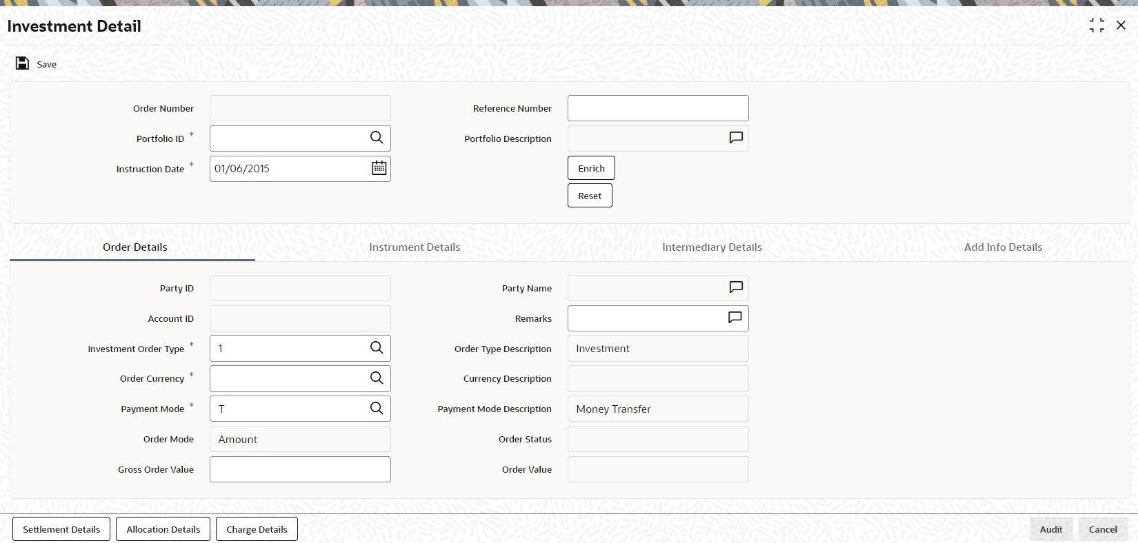

- Order Details Tab
This topic explains the Order Details of Investment Detail screen. - Instrument Details Tab
This topic explains the Instrument Details of Investment Detail screen. - Intermediary Details Tab
This topic explains the Intermediary Details of Investment Detail screen. - Add Info Details Tab
This topic explains the Add Info Details of Investment Detail screen. - Settlement Details Button
This topic explains the Settlement Details of Investment Detail screen. - Allocation Details Button
This topic explains the Allocation Details of Investment Detail screen. - Charge Details Button
This topic explains the Charge Details of Investment Detail screen.
