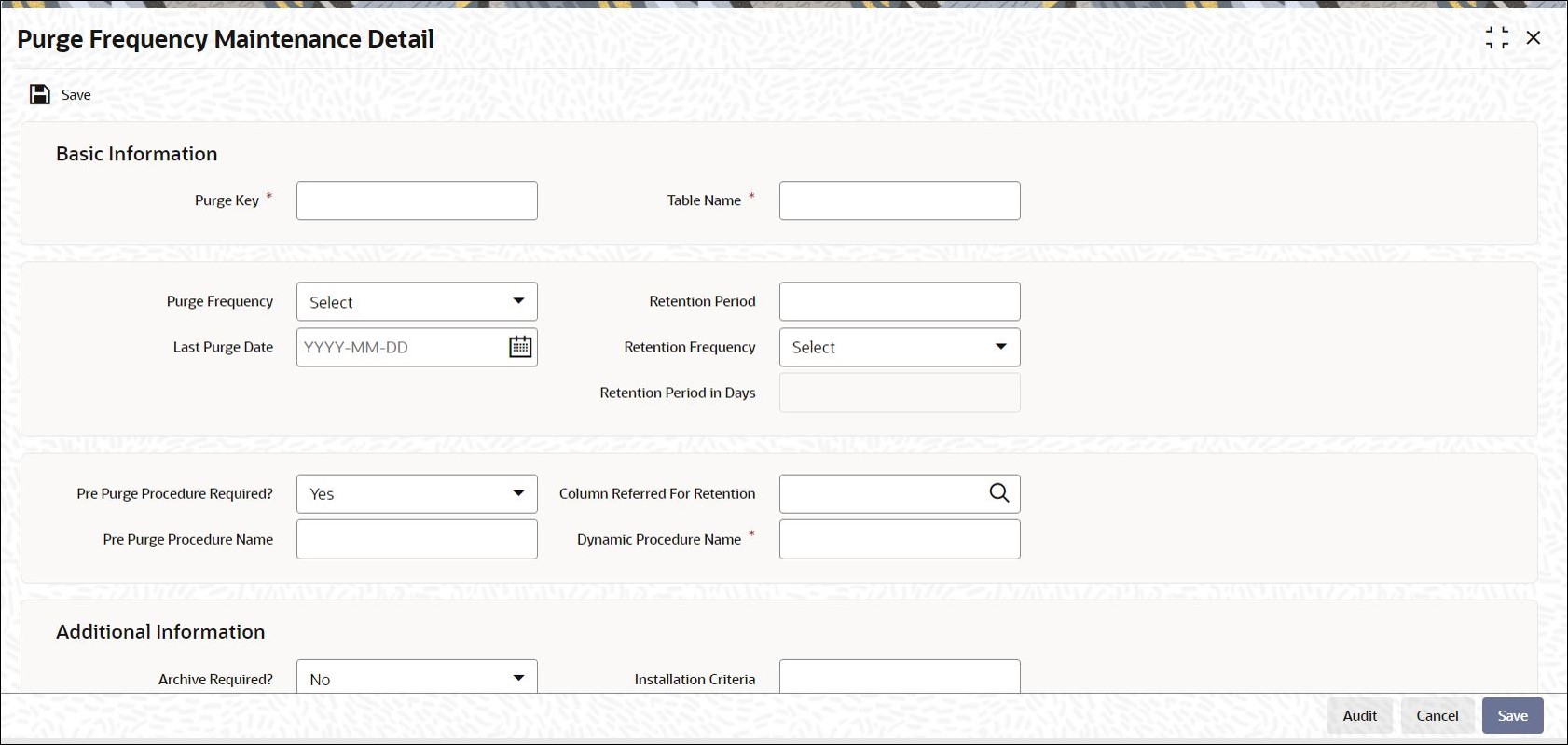

  1. On Home Screen, type UTDPURGS in the text box, and click Next.
    The Purge Frequency Maintenance Detail screen is displayed.
    Figure 1-1 Purge Frequency Maintenance Detail
  2. On Purge Frequency Maintenance Detail screen, click New to enter the details.
