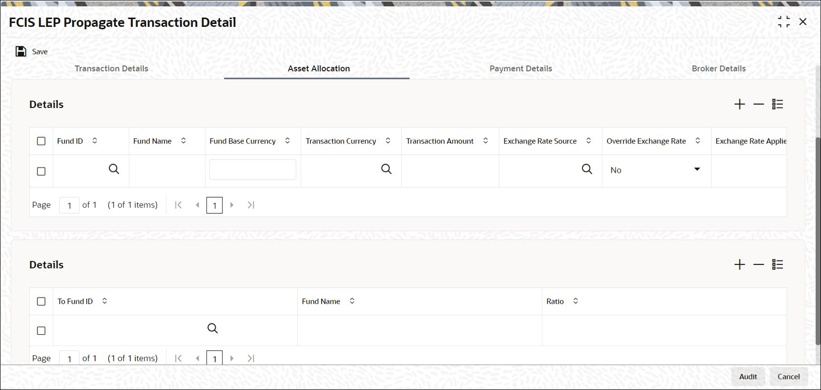

This topic explains the Asset Allocation tab of FCIS LEP Propagate Transaction Detail screen.
- On FCIS LEP Propagate Transaction Detail screen, click Asset Allocation tab to enter the asset allocation details for the transaction.
Capture the fund-wise pattern of distribution of the investment amount.
If the initial contribution that you enter is in different currencies, you need to mention the currency-wise details.
The Asset Allocation details are displayed.Figure 1-13 FCIS LEP Propagate Transaction Detail_Asset Allocation
- On Asset Allocation tab, specify the fields.For more information on fields, refer to the field description table.
