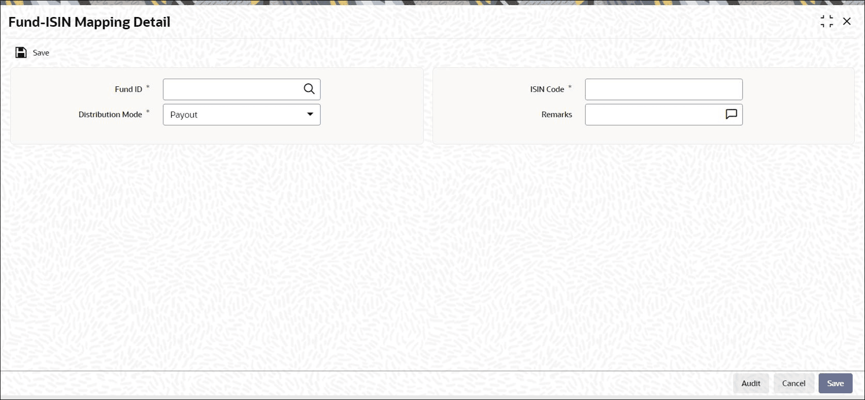

  1. On Home screen, type UTDFNDIS in the text box, and click Next.
    The Fund-ISIN Mapping Detail screen is displayed.
    Figure 1-1 Fund-ISIN Mapping Detail
  2. Indicate the income distribution modes for each association.
    The system displays the following distribution modes:
    • Payout
    • Reinvestment
    For instance, for a Fund-ISIN association, if the distribution mode maintained is Reinvestment, then during dividend processing, for the depositary unit holders whose beneficiaries have holdings in the fund mapped to the ISIN code, the dividend will be reinvested. The income distribution option for a fund-ISIN association must be unique. That is, each Fund-ISIN association can only be associated with one income distribution option. The Fund-ISIN association is an optional attribute for a fund, and can be maintained for any authorized fund as and when necessary.
  3. On Fund-ISIN Mapping Detail, click New to enter the details.
    Table 1-1 Fund-ISIN Mapping Detail - Field Description
    Field Description
    Fund ID Alphanumeric; 6 Characters; Mandatory
    Specify the ID of the fund that you are associating with an ISIN code and distribution mode in this screen.
    ISIN Code Alphanumeric; 12 Characters; Mandatory
    Specify the ISIN code to be associated with the fund that you have selected, for the selected distribution mode.
    Distribution Mode Mandatory
    Select the income distribution mode applicable for the selected fund and ISIN code from the drop-down list. For a fund-ISIN association, you can only associate one income distribution mode. The options available in the drop-down list are as follows:
    • Payout
    • Reinvestment
    Remarks Alphanumeric; 255 Characters; Optional
    Specify any applicable remarks for the fund-ISIN-distribution mode association.
