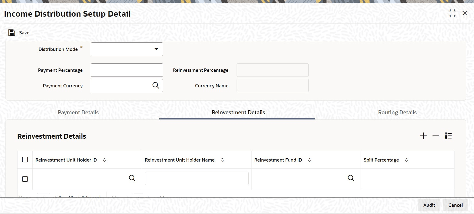

  1. On Income Distribution Setup Detail screen, click Reinvestment Details tab.
    The Reinvestment Details are displayed.
    Figure 3-3 Income Distribution Setup Detail_Reinvestment Details Tab
  2. On the Reinvestment Details tab, specify the fields.
