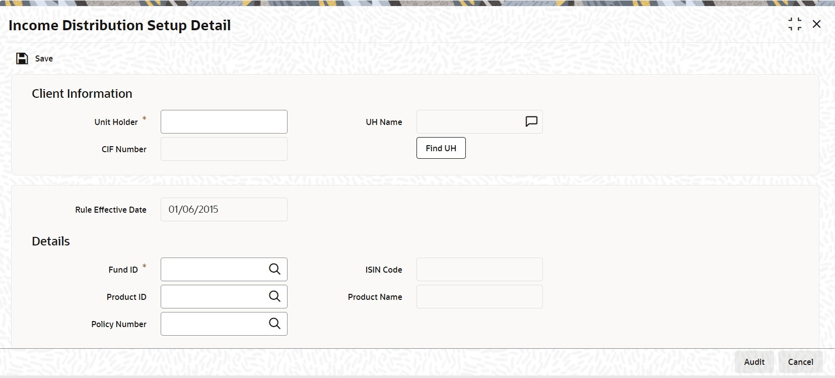

  1. On Home screen, type UTDUHIDS/ UTDFHIDS in the text box, and click Next.
    The Income Distribution Setup Detail screen is displayed.
    Figure 3-1 Income Distribution Setup Detail
  2. You can set up the IDS option in this screen.
    Specify the investor for whom the option is being set up, by indicating the CIF account associated with the unit holder, or the unit holder ID.
    Income distribution options are only setup at a unit holder account level, and not at a CIF account level.
    • Specify the fund for which the option is applicable, in the Fund ID field. You can also specify the ISIN Code for the fund. For LEP transactions, you can specify a combination of fund, policy and product, for which the option is applicable. The option you will set up will be applied only for dividend earnings on the fund/ combination of fund, product and policy you select here.
    • Specify the broker for whom the pattern is being setup, in the Broker Code field.
    • Specify the mode of distribution, in the Distribution Mode field.
    • Specify the percentages that represent the portions of dividend earnings to be paid and reinvested, as desired by the investor, in the Payment Percentage and Reinvestment Percentage fields.
    • Specify the payment details for the paid portion, in the Payment Details section, and the reinvestment details, for the reinvestment portion, in the Reinvestment Details section.
    • Save your changes.
  3. On Income Distribution Setup Detail screen, click New to enter the details.
    Table 3-1 Income Distribution Setup Detail - Field Description
    Field Description
    Client Information
    Select the ID of the unit holder for whom you are creating an income distribution setup record in this section.
    Unit Holder
    Alphanumeric; 12 Characters; Mandatory
    Select the CIF unit holder for whom you are creating an income distribution setup record from the list.
    CIF Number
    Display
    The system displays the number of the CIF Account under which the unit CIF Number is displayed when you select/ locate a unit holder by clicking Find UH button.
    UH Name
    Display
    The system displays name of the unit holder.
    Click Find UH button to query for unit holder details.
    Rule Effective Date
    Date Format; Mandatory
    Select rule effective date from the adjoining calendar.
    Details
    In this section, you can indicate the fund, policy and product, the income earnings from which will be distributed according to the IDS options you are creating for the selected unit holder.
    Various combinations at which the Unitholder IDS options can be set up, in order of preference are:
    Product + Policy + Fund level
    Product + Fund level
    In case of LEP transactions, if the UH IDS is not available, the dividend earnings will be reinvested into the default reinvestment fund maintained for the product in the Product Maintenance Detail screen. However, if the reinvestment fund is not defined, then the dividend is reinvested into the source fund itself.
    You can also indicate the manner in which the income must be distributed.
    Fund ID
    Alphanumeric; 6 Characters; Mandatory
    Select the ID of the fund from which the selected investor derives income, which will be distributed according to the IDS options you are creating in this screen.
    If the selected investor receives income from many funds, then you must create the IDS options for the income from each fund in this screen as applicable, if so requested by the investor.
    When you specify the ID of the fund, the ISIN code of the fund is displayed in the ISIN Code field.
    ISIN Code
    Display
    The system displays the ISIN Code for the selected Fund ID.
    Product ID
