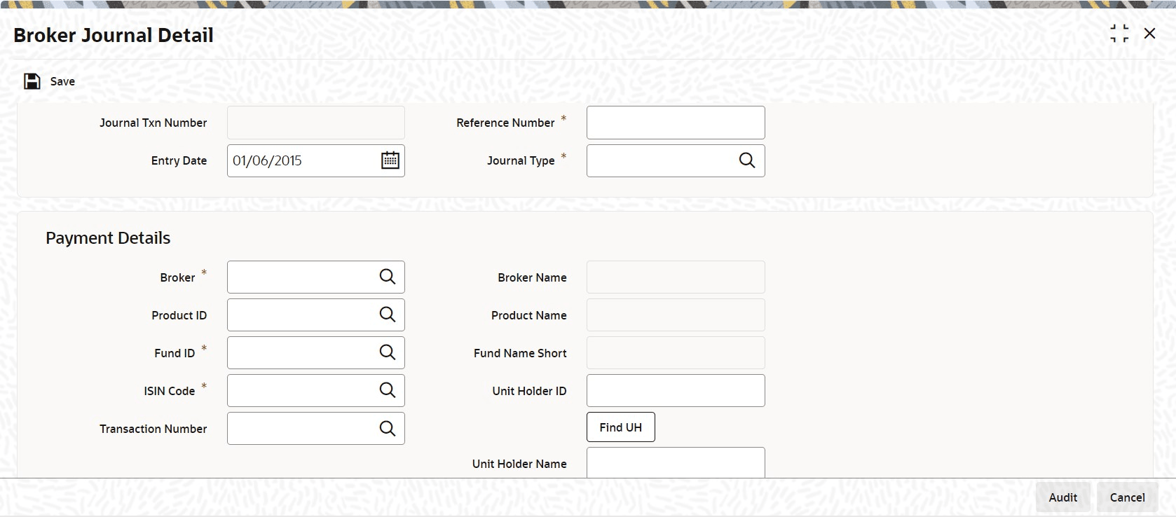

  1. On Home screen, type UTDBRKJR in the text box, and click Next.
    The Broker Journal Detail screen is displayed.
    Figure 4-17 Broker Journal Detail
  2. In the screen, specify the following mandatory information for each accounting entry for a broker, for a transaction in a fund:
    • The date of the entry, in the Entry Date field
    • A unique reference number for the journal entry, in the Reference Number field.
    • The currency for the journal entry, in the Journal Currency field.
    • The payable or receivables resulting from the transaction, in the Payables and Receivables fields.
    • Whether the entry is to be deemed an adjustment entry, as indicated in the Adjustment Entry field.
    • Any applicable descriptive or narrative text qualifying the entry, in the Remarks field.
    • The details of the mode of payment, in the Payment Details section.
  3. Click Save button to save your changes after you have specified this data.
    You must have another user to authorize a journal entry for the same to be reflected in the database.
  4. On Broker Journal Detail screen, click New to enter the details.
