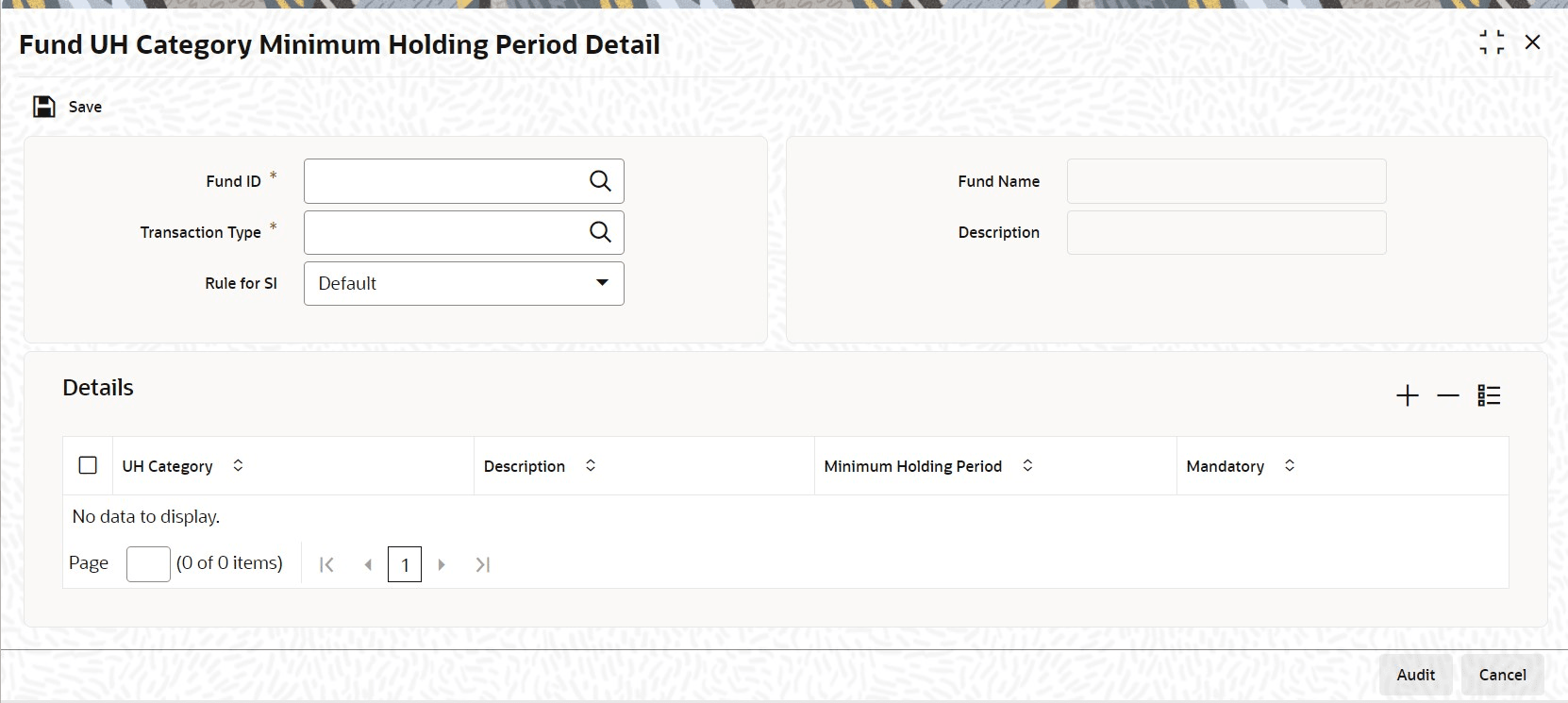

3.15 Process Fund UH Category Minimum Holding Period Detail
This topic provides the systematic instructions to capture the minimum holding period at Fund/ UH category/Transaction Type level.
