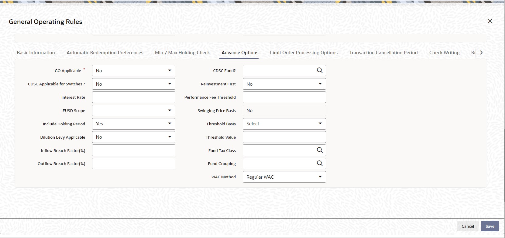

2.1.6.4 Advance Options
This topic provides information on advance options tab of general operating rules screen.
  1. Click on Advance Options tab in General Operating Rules screen to specify the details.
    The Advance Options details are displayed in General Operating Rules screen.
    For more information on fields in the screen, refer the below table.
    Table 2-13 General Operating Rules - Advance Options
