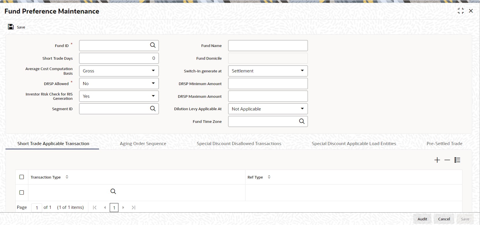

You can maintain fund preferences using Fund Preference Maintenance screen. For multi switch transactions, based on the maintenance the system will generate pseudo switch-In transactions at allotment or settlement of PS-Out leg.
  1. On Home screen, type UTDFPMNT in the text box and click Next.
    The Fund Preference Maintenance screen is displayed.
    Figure 3-16 Fund Preference Maintenance

    Table 3-17 Fund Preference Maintenance
    Field Description
    Fund ID Alphanumeric; 6 Characters; Mandatory
    Specify the fund ID for which the preference needs to be captured. Alternatively, you can select Fund ID from the option list. The list displays all valid fund ID maintained in the system.
    The system will validate the fund ID for the unique record.
    Note: In GTA setup and in case of Hedge Fund, field Fund ID should belong to the same Segment as Linked Hedge Funds.
    Fund Name Display
    The system displays the name of the fund for the selected Fund ID.
    Fund Domicile Display
    The system defaults the fund domicile based on the Fund ID selected.
    Short Trade Days Numeric; 22 Characters; Mandatory
    Specify the Short Trade Days.
    Average Cost Computation Basis Optional
    Select the Average Cost Computation Basis from the drop-down list. The list displays the following values:
    • Net - If you select this option, the system will use net amount in average cost computation.
    • Gross - If you select this option, the system will use gross amount in average cost computation.
    By default, Net option will be selected.
    For off-shore fund, the system will not consider the values selected in this field for average cost computation. For off-shore fund, it is always Gross Amount.
    DRSP Allowed Mandatory
    Select if DRSP is allowed for a fund or not from the drop-down list. The list displays the following values:
    • Yes
    • No
    Investor Risk Check for RIS Generation Optional
    Select if investor risk is checked for RIS generation from the drop-down list. The list displays the following values:
    • Yes
    • No
    Switch-In generate at Optional
    Select the pseudo switch-in transaction generate at option from the drop-down list. The list displays the following values:
    • Settlement
    • Allotment
    DRSP Minimum Amount Numeric; 18 Characters; Optional
    Specify the DRSP minimum amount required for a DRSP transaction.
    DRSP Maximum Amount Numeric; 18 Characters; Optional
    Special the DRSP maximum amount allowed for a DRSP transaction.
    Dilution Levy Applicable At Optional
    Select Dilution Levy Applicable At transaction level from the drop-down list. The list displays the following values:
    • Not Applicable
    • All Transactions
    • Specific Transaction
    If you have selected Dilution Levy Applicable as Yes at Fund Family Detail screen then, at fund level, Dilution Levy Applicable field should be selected as Yes only.
    You should select Dilution Levy Applicable At field as All Transactions only at Fund Preference screen.
    If Dilution Levy Applicable at Fund level is Yes and Fund family level is No then, then you can select either All Transactions or Specific Transaction option.
    If Dilution Levy Applicable at Fund level is No then, you should select Not Applicable option.
    Refer the Table 3-18 for the dilution levy load applicability.
    Fund Time Zone Mandatory; Non-amendable
    Specify the Fund Time Zone. Alternatively, you can select it from the option list. The list displays all the Fund Time Zones maintained in the system.
    Note: The time zone maintained in the Default Maintenance Screen of the Fund Manager module will be defaulted to the Fund Preference, if the value is not already provided. If the Default Time Zone value is null, then the system will display an error message.
