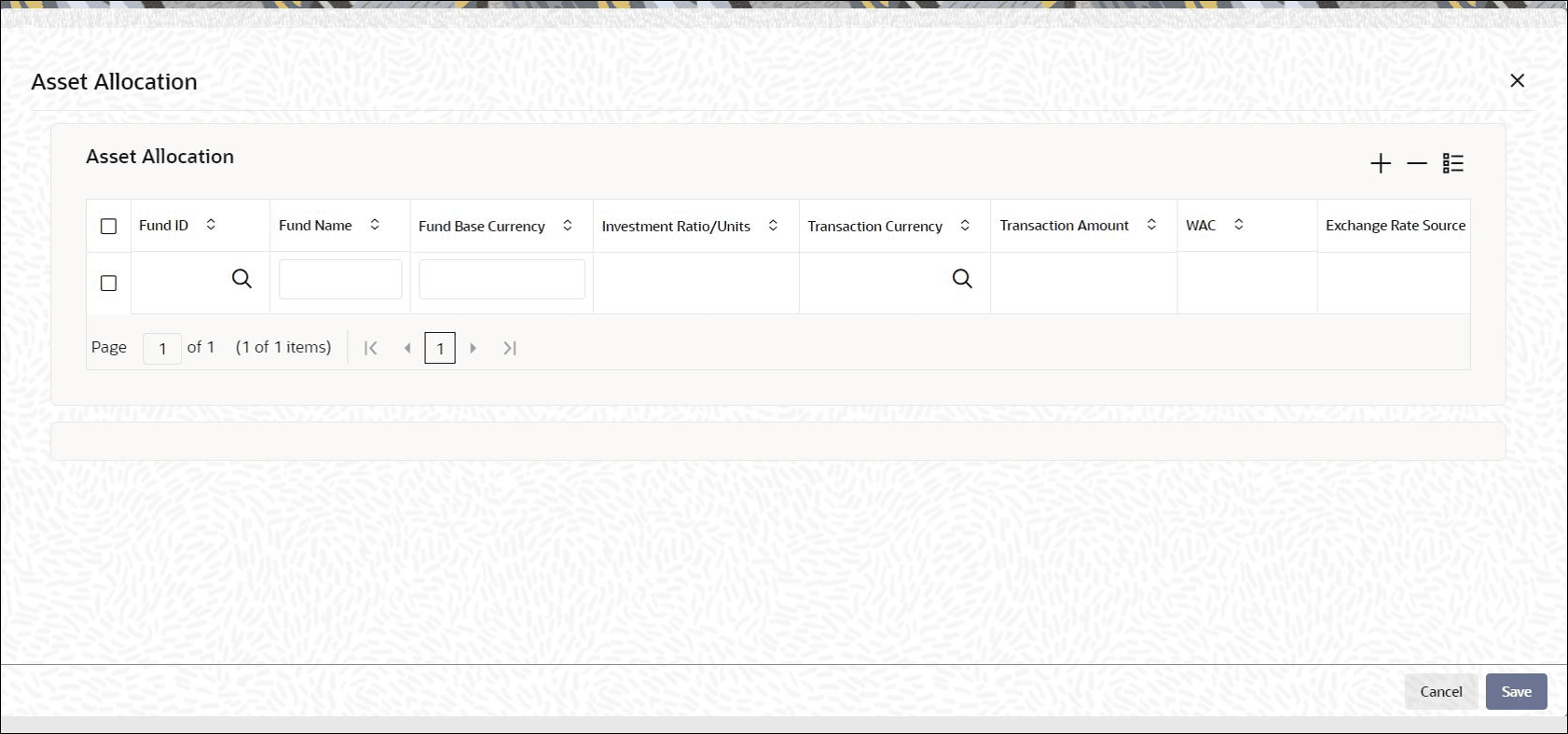

2.1.9 Asset Allocation Button
This topic explains the Asset Allocation button of Policy Maintenance Detail screen.
The initial contribution towards the Policy can be directed into any number of mapped funds for the product, and annuity is paid out to the Policy Holder from any of these funds.
The asset allocation details that you specify here will be applicable to only the initial contribution towards the policy, and not the annuity and premium payments.- On Policy Maintenance Detail screen, click
Asset Allocation button to process the
Asset Allocation screen.The Asset Allocation screen is displayed.
Figure 2-10 Policy Maintenance Detail_Asset Allocation Button
- On Asset Allocation screen, specify the fields.For more information on fields, refer to the field description table.
