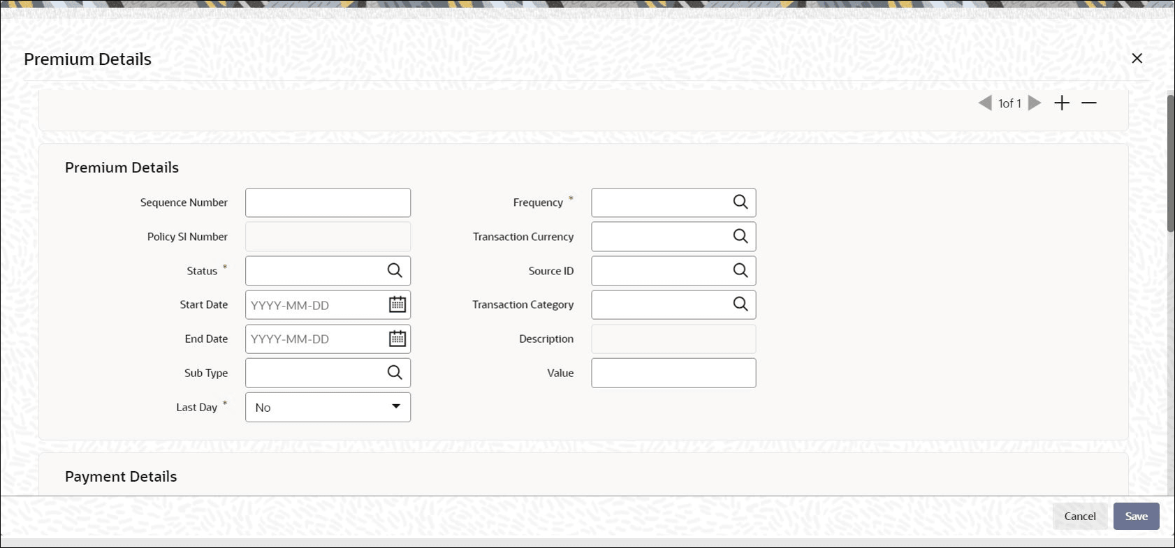

- On Policy Maintenance Detail screen, click Premium Details button to enter the details of the premium payment and the frequency at which the premium payments will be made.You can enter the details for more than one premium.The Premium Details screen is displayed.
Figure 2-11 Policy Maintenance Detail_Premium Details Button
- On Premium Details screen, specify the fields. For more information on fields, refer to the field description table.
