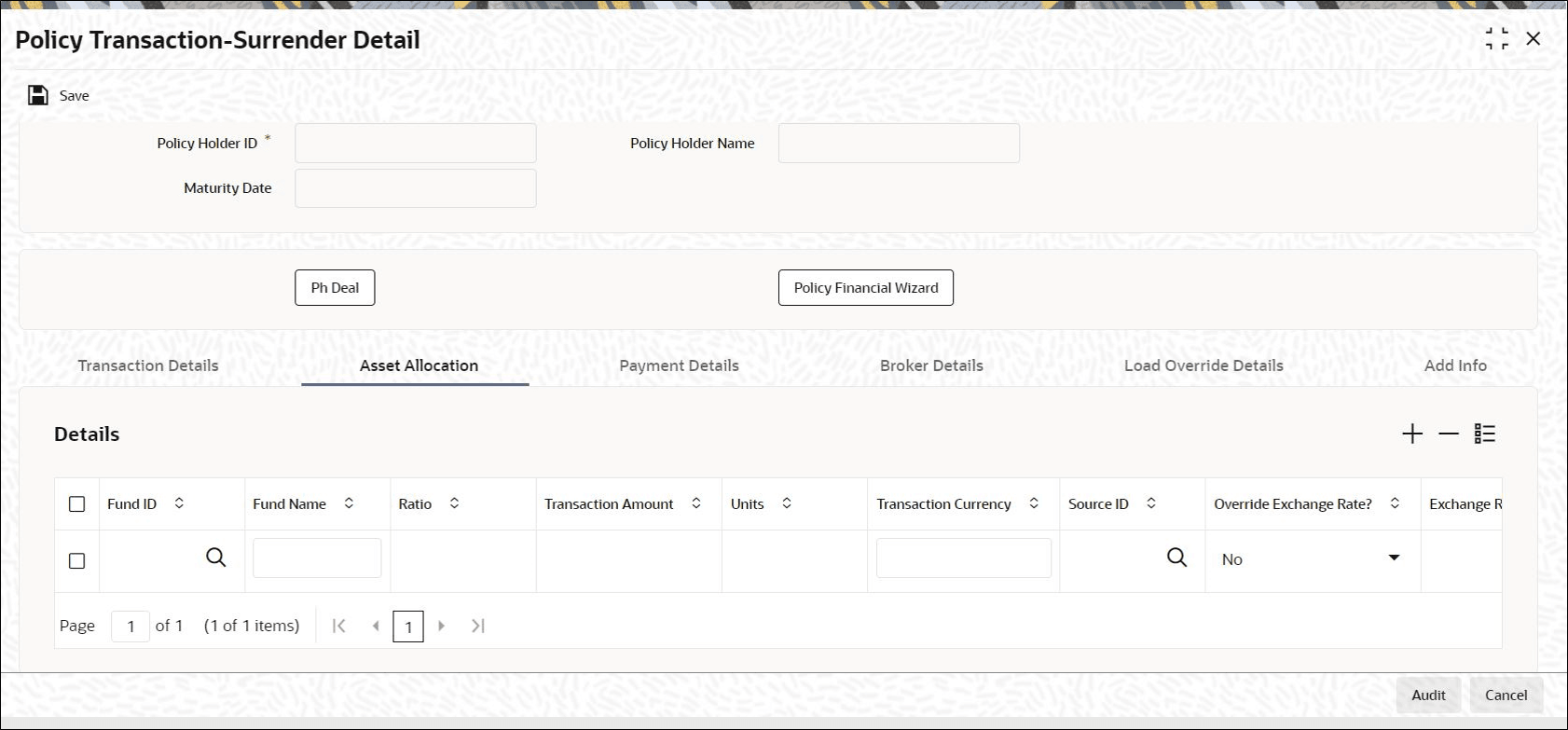

5.1.4 Asset Allocation Tab
This topic explains the asset allocation tab of Policy Transaction-Surrender Detail screen.
  1. On Policy Transaction-Surrender Detail screen, click Asset Allocation tab.
    The Asset Allocation details are displayed.
    Figure 5-5 Policy Transaction-Surrender Detail_Asset Allocation Tab
  2. Capture the fund-wise pattern of distribution of the surrender amount in the Asset Allocation Details section of this tab. If the redemption is in different currencies, you need to mention the currency-wise details here.
  3. On Asset Allocation Tab, specify the fields.
    For more information on fields, refer to the field description below,
    Table 5-4 Asset Allocation - Field Description
