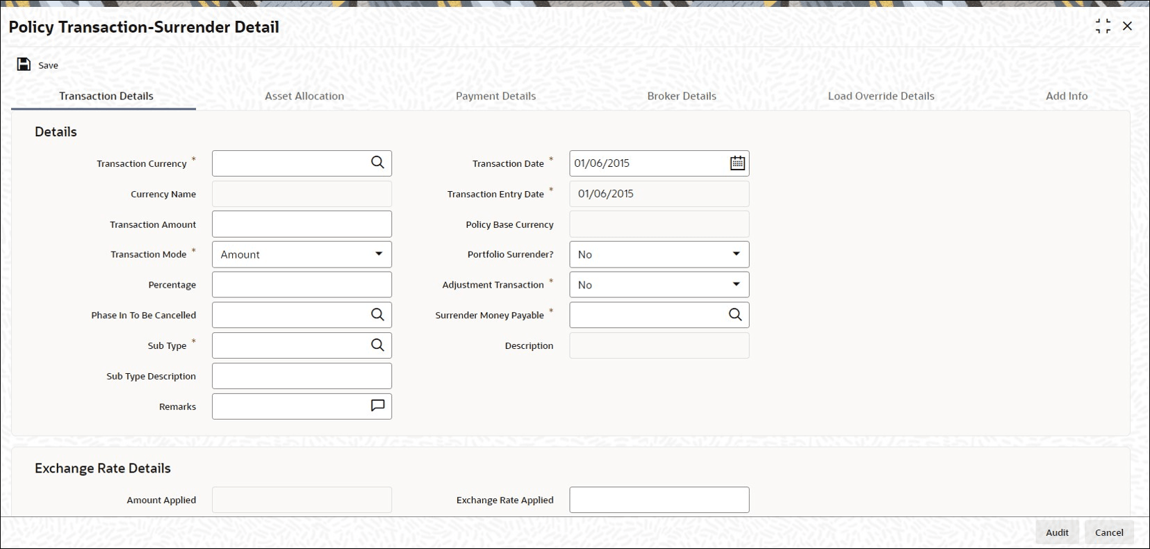

- On Policy Transaction-Surrender Detail screen, click Transaction Details tab.The Transaction Details are displayed.
Figure 5-4 Policy Transaction-Surrender Detail_Transaction Details Tab
- On Transaction Details tab, specify the fields.For more information on fields, refer to the field description table.
Table 5-3 Transaction Details - Field Description
Field Description Transaction Details This section displays the following details.
Transaction Currency Alphanumeric; 3 Characters; Mandatory
If redemption is done in a currency other than the policy base currency, then you are required to specify the transaction currency. If you do not, then the system will default the base currency of the corresponding policy or plan from the Policy details record as the transaction currency.
Currency Name Display
The system displays the currency name for the transaction currency.
Transaction Date Date Format; Mandatory
Specify the date for the transaction. You can enter a backdated transaction here, if backdated transactions are allowed in the corresponding product. If backdated transactions are not allowed, then this date must not be earlier than the application date.
The transaction date must be earlier than the End Date of the Policy, and must not be a holiday. The transaction date cannot be earlier than the first Rule Effective Date of the policy.
Transaction Entry Date Display
By default, the application date is displayed in this field, and it cannot be altered.
Transaction Amount Numeric; 30 Characters; Mandatory if the Transaction Mode is ‘Amount’
Specify the portion of the transaction amount that is to be redeemed in each of the selected funds. The sum of these amounts must not be greater than the total transaction amount specified in the transaction details tab for this transaction. Typically, this field is only applicable for transactions for which the mode is Amount.
Policy Base Currency Display
When the Policy is selected, the corresponding Plan (or Policy) Base Currency is displayed here from the policy details record. This currency cannot be changed at this stage.
Net based transactions will be allowed only for amount based surrenders and in case of 100% surrender, unit based gross transactions will be generated.
For surrender transactions Account currency of garnishee should be same as Policy base currency.
For annuity transactions also, the Account currency of garnishee should be same as Policy base currency.
Transaction Mode Mandatory
Select the mode in which the transaction must be put through, from the drop-down list. The list displays the following values:- Amount
- Percent
- Units
Portfolio Surrender? Optional
You can select Yes to indicate the surrender is a complete or partial surrender transaction within the funds in which the investor as invested.
Percentage Numeric; 5 Characters; Mandatory if Transaction Mode is ‘Percentage of Holdings’
If the specified Transaction Mode is Percentage of Holdings, then specify the percentage of the Policy Holder’s holdings that is to be reckoned as the transaction amount for this transaction.
When you specify this percentage, the transaction amount is computed and displayed in the Transaction Amount field, and locked. In case you have specified the percentage as 100, then the transaction amount is displayed as zero.
The percentage you specify here must not exceed one hundred.
Adjustment Transaction Mandatory
Select the adjustment transaction status from the drop-down list.
If the transaction is an adjustment withdrawal, then system would not validate the No. of withdrawals allowed at Product/Policy level. Also, the withdrawal counter at the policy level would not be updated.
Phase In To Be Cancelled Alphanumeric; 16 Characters; Optional
You can choose to cancel all, none or specific IDs of the active PhaseIn setup.
Sub Type Alphanumeric; 3 Characters; Mandatory
Specify the sub type.
Sub Type Description Display
The system displays the description for the selected sub type.
Surrender Money Payable Alphanumeric; 1 Character; Mandatory
Specify to whom the surrender money is payable, by selecting the same from the option list.
Description Display
The system displays the description for the selected surrender money payable.
Remarks Alphanumeric; 255 Characters; Optional
Enter a brief description of the transaction, or any applicable remarks about the transaction.
Exchange Rate Details The policy transaction currency can be different from the base currency of the policy. In this section, you can maintain the details related to the exchange rate to be used for currency conversion.
Amount Applied Display
The amount calculated based on the exchange rate specified gets displayed here, after the calculation.
Exchange Rate Applied Alphanumeric; 21 Characters; Optional
The exchange rate corresponding to the combination of policy base currency and policy transaction currency gets displayed here. The exchange rate for a surrender transaction will be between policy base currency and transaction currency.
Source ID Alphanumeric; 6 Characters; Mandatory
Specify the source from which the exchange rate is obtained or select the source ID from the option list provided.
Override Exchange Rate Optional
Select the option to indicate if you wish to override the exchange rate that gets defaulted.
Select Yes to indicate that you wish to override the exchange rate and No to indicate otherwise.
FX Deal Date Date Format; Optional
Specify the FX deal date.
FX Value Date Date Format; Optional
Specify the FX value date.
