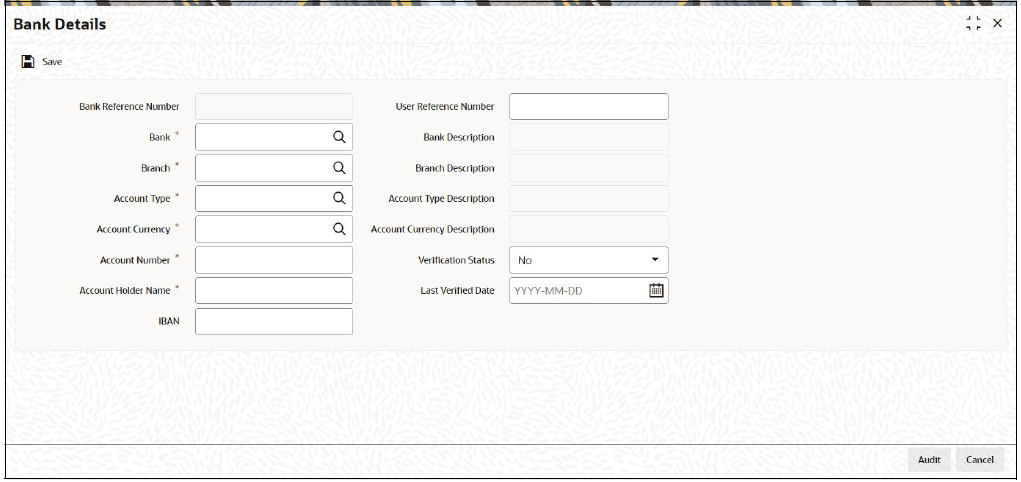

1.58.5.1 Bank Details Button
This topic explains the Bank Details Button of Settlement Details button.
  1. On Settlement Details screen, click Bank Details tab to view the following details.
    The Bank Details are displayed.
  2. On the Bank Details tab, specify the fields.
    For Group pensions, the system defaults the Instrument Administrators bank account during the hand-off. For private investments, the system will use the bank accounts of the parties mapped at investment account level (PADINVAC).
The system displays the following details:
  • Bank Reference Number
  • Bank
  • Branch
  • Account Type
  • Account Currency
  • Account Number
  • Account Holder Name
  • IBAN
  • User Reference Number
  • Bank description
  • Branch Description
  • Account Type Description
  • Account Currency Description
  • Verification Status
  • Last Verified Date
You can amend all the details except in the header post authorization prior to order hand-off to TA.
