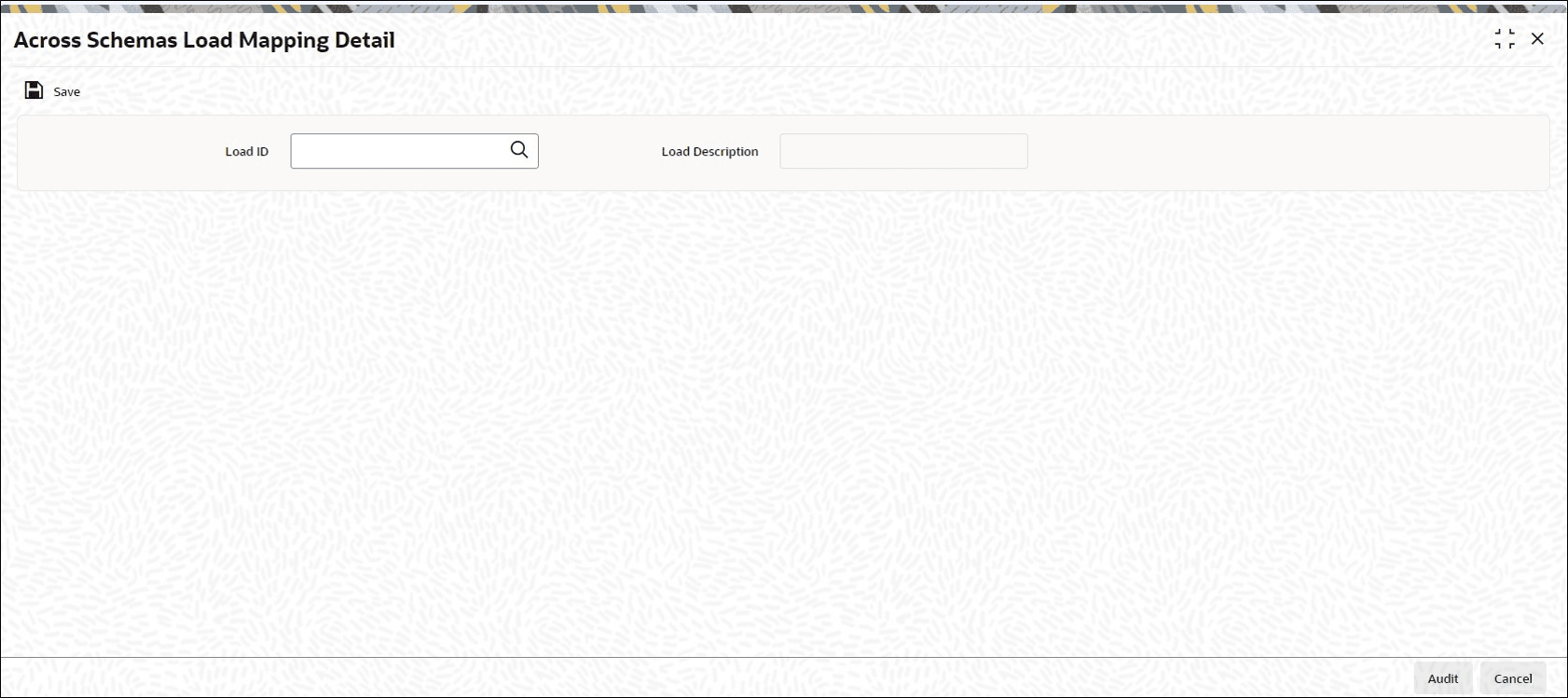

  1. On Home screen, type UTDLOAMP in the text box, and click Next.
    The Across Schemas Load Mapping Detail screen is displayed.
    Figure 7-8 Across Schemas Load Mapping Detail
  2. On Across Schemas Load Mapping Detail screen, click New to enter the details.
    Table 7-9 Across Schemas Load Mapping Detail - Field Description
    Field Description
    Load ID Numeric; 5 Characters; Mandatory
    Specify the load ID across schema will be available for mapping. Alternatively, you can select the load ID from the option list. The list displays all valid load ID maintained in the system.
    Load Description Display
    The system displays the description for the selected load ID.
