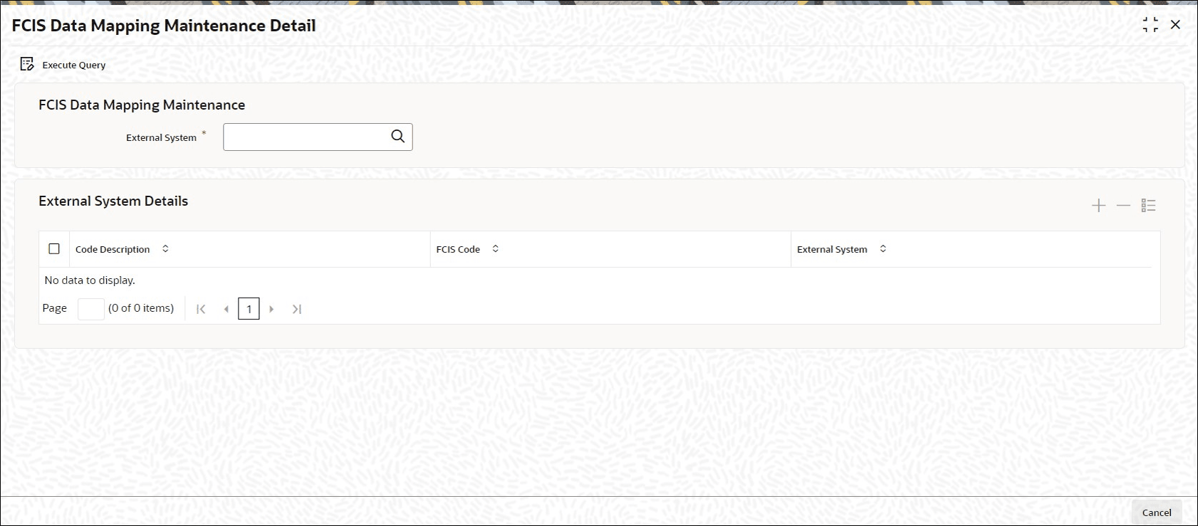

  1. On Home screen, type UTDDMAP in the text box, and click Next.
    The FCIS Data Mapping Maintenance Detail screen is displayed.
    Figure 3-14 FCIS Data Mapping Maintenance Detail
  2. On FCIS Data Mapping Maintenance Detail screen, click New to enter the details.

    Field Description
    External System Alphanumeric; 30 Characters; Mandatory
    Specify the external system from which the data needs to be mapped. The options being:
    • CAMS
    • TEMPLETON
    • KARVY
    • HSBC
    • Oasis
    External System Details
    The section displays the following fields.
    Code Description Alphanumeric; 100 Characters; Mandatory
    Specify the category of codes from factory shipped values available.
    FCIS Code Alphanumeric; 255 Characters; Mandatory
    Specify the corresponding factory shipped value available in FCIS for the specified category code.
    External System Code Alphanumeric; 50 Characters; Mandatory
    Specify the external system code here.
    Note: If the code description selected from the available list is linked to any existing PARAMS, system would display all valid codes irrespective of the maintenance.
