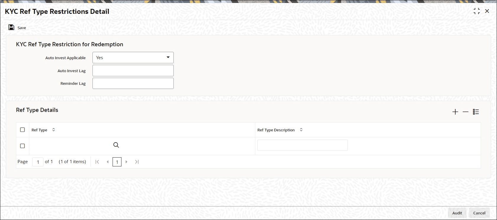

  1. On Home screen, type UTDKYCRE in the text box, and click Next.
    The KYC Ref Type Restrictions Detail screen is displayed.
    Figure 2-62 KYC Ref Type Restrictions Detail
  2. On KYC Ref Type Restrictions Detail screen, click New to enter the details.
    Table 2-59 KYC Ref Type Restrictions Detail - Field Description
    Field Description
    Auto Invest Applicable
    Optional
    Check this box to indicate auto investment feature is applicable.
    Auto Invest Lag Numeric; 22 Characters; Optional
    If auto investment feature is applicable, then you need to specify the payment lag in days, if any, to be applicable for redemption payouts.
    Reminder Lag Numeric; 22 Characters; Optional
    Specify the reminder lag, in days, after which reminders must be generated for the redemption payout. The reminder lag must be less than the auto invest lag period specified in the previous field.
    Ref Type Details Section This section displays the following fields.
    Ref Type Alphanumeric; 50 Characters; Optional
    Select the code of the reference type from the adjoining option list.
    Ref Type Description Display
    The system displays the description of the selected reference type.
