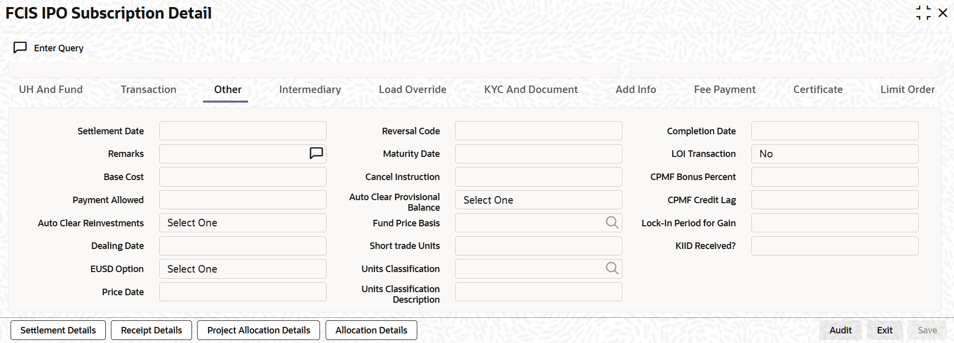

3.4.4 Other Tab
This topic explains the other tab of FCIS IPO Subscription Detail.
  1. On the FCIS IPO Subscription Detail screen, click on Other tab to enter the details.
    The Other details are displayed.
    Figure 3-6 FCIS IPO Subscription Detail - Other
  2. On Other tab, specify the fields.
    For more information on fields, refer to the field description below,
    Table 3-12 Other Tab - Field Description
